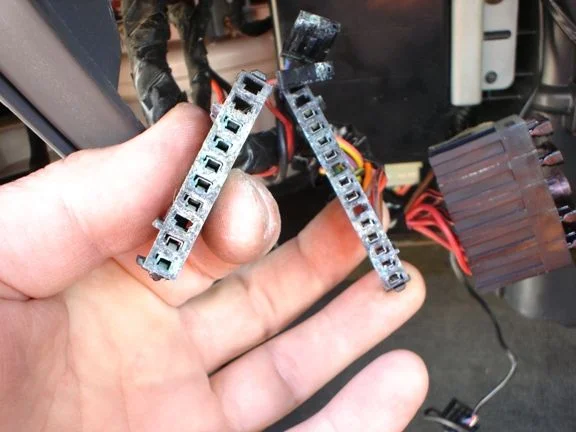

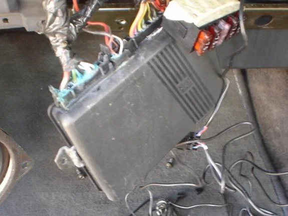

The unit under the PS dash on my RHD UK model is the OE alarm system, not the most reliable system inthe world however it is getting on a bit now. Mine had been leaked on by the poor windscreen rubber sealing. I have posted you a couple of pics to help you ID the unit and plugs. If that is not the unit I apologise for wasting your time.

it was a bit of a pain to pull out, and I finally decided to snap it loose (broke a piece of the hold-down mount that's been replaced by the new part).. the FSM would likely tell you to evac the refrigerant and drop the evaporator, but you can get to it without doing so, just have to do some Houdini hand moves to get at it...
unlike the experience of others here on mud, I didn't have fixable corrosion or leads, this part looked nearly new when I pulled it out, it had just failed over time, so a replacement was required.
thanks KG for the technical advice and quick responses.. saved me some money and a long hot roadrtip to TX this weekend
If anyone needs a pic or the part number let me know and I'll send what's on the dealer receipt.

So I assume that it all works fine now?
If so congrats and enjoy your AC.
That thing is a real PITA to get at.
If you could post up the part number that would be great, you never know.

just drove 1200 miles in 4 days (Pensacola to Dallas and back) and the truck did great.. even with 105 degree temps in Dallas area, had to mix the warm/cold in my vents to keep it from being "too cold"..
my receipt gives part number
88630-20020, "Relay Assy"
when we researched it on the computer based parts catalog at the dealer, the item was title "cooling system relay" (or something similar, but the word "cooling" was definitely in there to distinguish it from other relays).. 77.21 at my local dealer, plus tax
cheers
