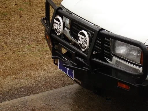

You can do the po' boys winch set up like I have for a while until you decide. At least it covers up the hole.
wob is online now   Reply With Quote
