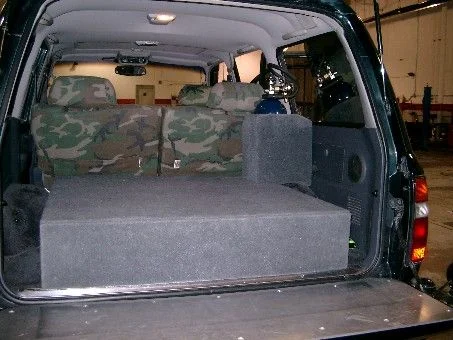

Mine is made from 1/2 inch plywood and is covered in a carpet material that I sourced from our dashmat vendor. It is bolted to the floor utilizing the third row striker mounting holes. The slide-outs are Rubbermaid storage boxes with wheels on the bottom and are designed to slide under beds. The box is designed so that .30 and .50 caliber ammo cans can also be slid in....

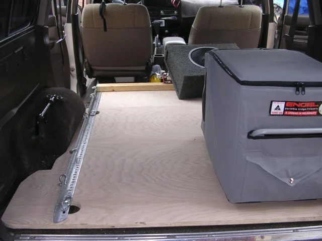

I've decided to go with a cargo floor...
