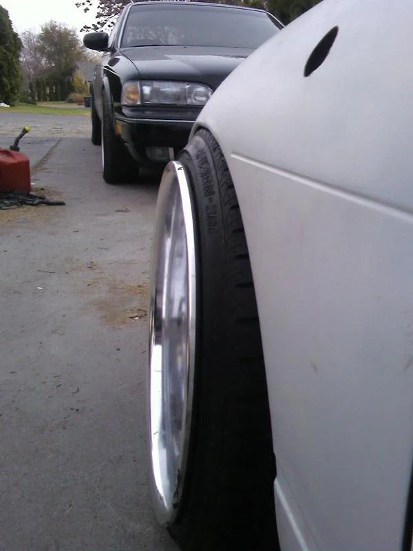

You should be just fine, it may be a little difficult to seat the bead, but once it's seated it'll be fine. My Buddy has a bunch of VW's (and a Toyota or he wouldn't be my buddy ) but they strech tires far more than you are speaking with no problems.

Plus you have a hell of a lot more side wall than a 40 series tire and they run rims that are 2" sometimes even wider than the tred itself. But expect to throw more beads if aired down and wheeling (probably won't be doin much wheeling with snow tires).
So long answer short, you're not S.O.L.

Quote:
Thats scary looking
you don't actually get in that and drive around, do you?

Quote:
The look comes from Germany where the law is the tread of the tire can't stick out past the fender arches. They strech the tires so that they can run a deep dished wheel. Yes, we drive around on them and no it hasn't been an issue.
To the OP, you will not have an issue running that tire on your stock rim... However, IMO it will look funny.
No, acctually I don't, I found the pic using google, but I do drive around in my buddies Corrado that has tires streched the same exact way, they don't come unseated. It takes alot to throw a bead on a fully inflated tire, esspecially on the road, let alone an icy one.
... It takes alot to throw a bead on a fully inflated tire, esspecially on the road, let alone an icy one.
On a 40 series maybe, but I wouldn't go around too long doing the same with an 85 series.
