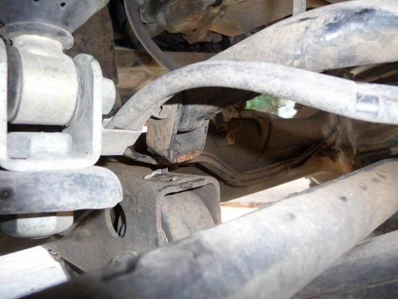

Mine broke on the John Bull trail in Big Bear.It didnt damage my brakes though. Tie wired it for now but Im thinking of removing it. For a dedicated trail rig I would remove it.
Mine broke in that exact same spot. I think it's a weak point on these rigs. I had it welded because mine is a daily driver, but if mine were trail only I would take the front off asap to avoid the brake line issue.
