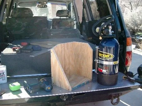

Where to put that Power Tank...?
Well,
Cheap old me finally slapped leather for a Power Tank. (Thank you Christo ) I got tired of mooching off of fellow club members after each run....
Now that I had one I needed to figure just where to put it so that it would be stored safely and in a place that would not get burried by all our other crap....
So after a few cheap beers, I came up with this:

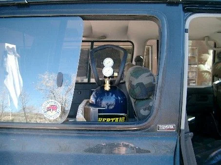

Hookup is accessed by sliding open the quarter window and the tank is removed from the box by tipping the rear seatback forward. Since these photos were taken I have covered the box with the same material that is on the drawers. I have not had good light to take additional photos but will do so this weekend. It looks much better covered.

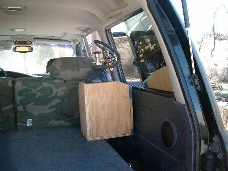

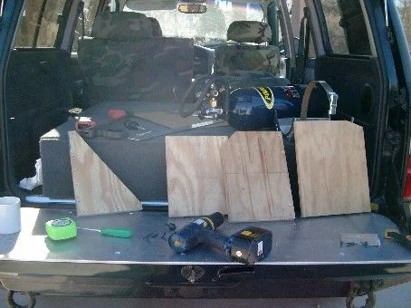

zp ;olr yjr dofr eomfpe svvrdd/ That's "I like the side window access" when you're not on the home keys...
So, what's the angled cutaway for that goes top to bottom - ease of removal when you fold the seat forward a bit, or run out of lumber?

Dan, that's almost exactly what I did for mine, except I was lazy and just bought a bracket.
I also liked the positioning as it would be very easy to hit all four tires. I go out the passenger slider, like you, or the driver side second row window. Check out these pics (tank stuff starts at picture #20):

Dan, that's a slick installation. Does the bottle fit tightly enough so it doesn't rattle around off-road? What happens if you decide to travel with the rear seats folded forward?
Does anyone have pics of a Power Tank installation in the back of a Cruiser that doesn't have a raised load floor? Thanx.
Take another look at his second picture. There is a mounting bracket strapped to the tank. Then look at the fourth picture, you can see that bracket up against the plywood. My gues is that he has that mounting bracket fastened to the plywood somehow. Very nice installation!
John,
Chris Geiger posted pictures of his bracket about a year ago in this thread. I see that the pics did not survive the forum changes. I copied his design and made a few changes. My bracket is made from steel and is welded to the 3rd row bracket that bolts to the floor. Mine has multiple holes and will allow for a horizontal mounting (like Chris') or a single verticle or dual (back-to-back) verticle mounted tanks.
I'll try to post some pics but it will be sometime this weekend.
