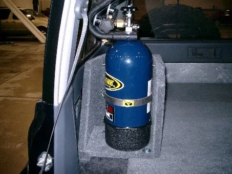

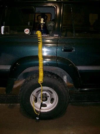

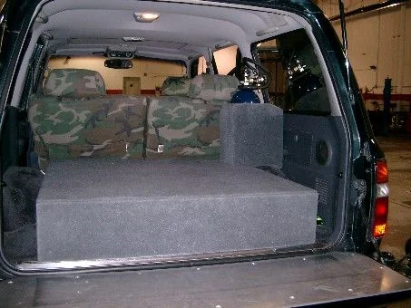

Here are a few views of the finished product. The tank is secured in the box by the Powertank aluminum bracket. There is no movement at all unless you grab ahold of the tank handle and really torque on it. The hose reaches all 4 corners easily and the tank can be pulled out by flipping the second row seat back down in just a few seconds. All-in-all I am quite pleased with the results.

Good eye. It is 1/4 inch 6061 tempered. The sheet weighs 23 lbs and is secured to the gate with 6 mm counter-sunk machine screws. I set 6 mm Nutserts in the original clip holes. The gate is much sturdier now and the Coleman stove can sit on it without starting a fire
D-
Dan - That really looks good all finished. Its hard to tell from the pics, but are the drawers and powertank holder covered in carpet or is that some of that spray-on speckled stuff you can get at Home Depot?

Actually that is bulk "carpet" material that I purchased from our supplier of dash mats. They will sell it in bulk by the foot. It is the same stuff that they make dash mats out of. IIRC it is 39 inches wide.
I attached it with a 3M product that is a spray on contact cement.
