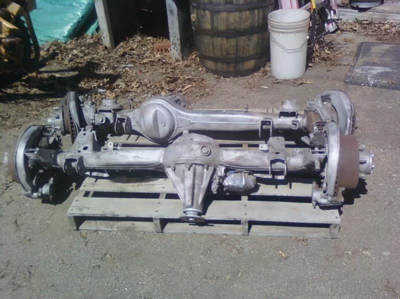

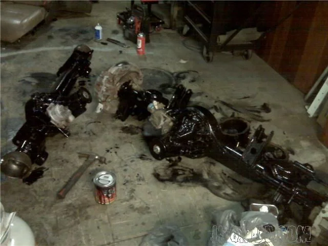

i grabbed an 80 up in Maine for parts and the axles were in about the same condition yours are in so i had them sand blasted then I por15 and top coated them with spray paint, not sure if you want to get that route but it was a fun project
you can see the knuckle balls in boath pics its a good before and after shot
oh and 2nd getting some greese in there now it most likely dry and need a rebuild
