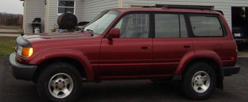

Just installed J springs/35x12.50x15's

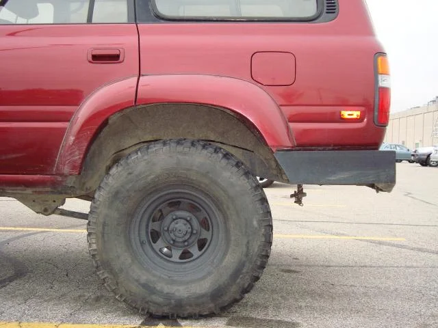

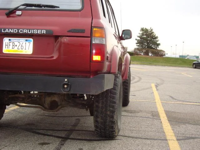

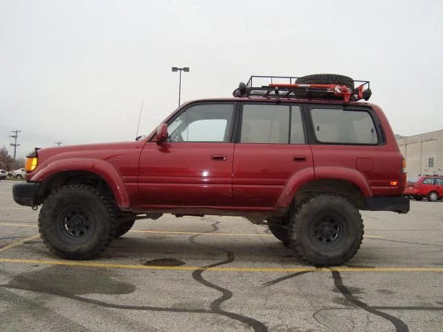

Here's a few pics of my rig. The first is a before (the only one I have, after I took the running boards/front flares off).

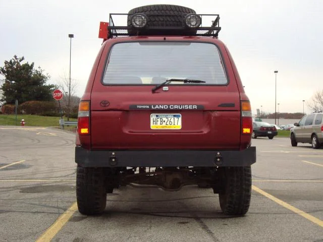

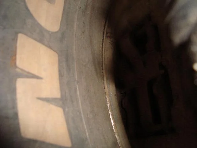

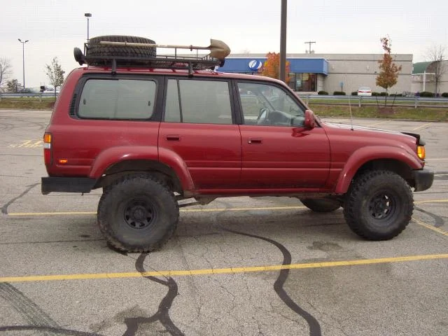

Sorry, I'm at work and it took me a min to format the pics.
After the lift, tires, home made bumper/roof rack...

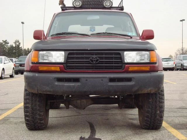

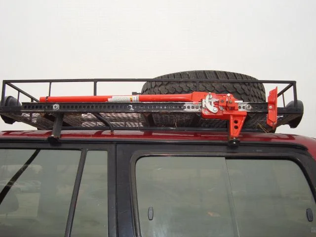

And I meant to say mud flapps, not flares, haha
Some more

nice!...what are you using for caster correction? hows the 3FE with the 35's..

One More....
I painted the grill/headlight trim and the emblems on the tailgate with truck bed linner, as with the rack and bumper, I love the stuff, but I don't think it turned out bad, better than the factory gold kit, haha

Haven't done anything for castor/shocks/bumpstops/swaybars yet. Hasn't seemed to be a problem, I am going to fab up some castor correction plates. As for the 35's, they don't seem to be much different, but then again mine's a 95, so it doesn't have a 3FE, I got a 1-FZ.

The 15" wheels fit very nicely with the 1" WS. I could have gotten away with less, but I wanted the tires to be flush with the flares.

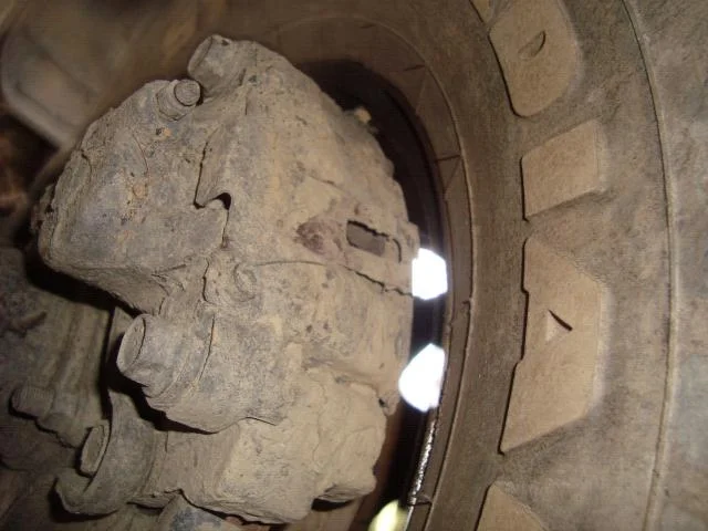

What wheels are you running? I ask because most 15's won't clear the brakes. I'm assuming the wheel spacers allowed you fit them.?.? Did you get new brake lines or did the stockers reach?

They're 15" wagon wheels, I believe the BS is around 3", and yes I needed about 1/2" of wheel spacers to make them fit, but I went with 1". I think it's cheaper in the long run to run 15" wheels as tires are a dime a dozen compared to 16"ers.

a "wagon" wheel? I like them. Need more info! I was wondering if the 15" will fit my LX. Looks like I will still need my spacers if I go this route.

Thank you, they are some cheap steel wheels, I think from summit. I will measure the backspacing and let you know. With the wheel spacers I have about 1/2" of clearence between wheels/caliper. But if they fit mine, they'll fit yours as there's no difference between the LC/LX in that regaurd.

Fitting 15" wheels without clearancing the brake calipers sounds fishy on a FZJ...

I don't see what's fishy? They either clear or they don't and mine fits with about 1/2" clearance in the front and about 1/4" in the rear. Once they are bolted up it's not like they are gonna suddenly move unless the wheel or spacer comes loose. In that case you have bigger problems to begin with.

I'm thinking that you either have smaller brakes or they have been clearanced already. FZJs run 16" wheels because of brake clearance. How they fit without modification makes me wonder...that's all.

I plan on doing shocks and extended stainless break lines in the near future. As well as castor correction in the semi-near future. I can't save enough to buy everything at once, I end up going to the bar and spending it
This way it's driveable and wheelable. The tires fully tuck in the rear with no rubbing whatsoever, so no need to drop the bumpstops. The front bumper needs trimmed a bit, but other than that everything fits nicely.
Question?
Does anyone make a purpose built shock for the FJ/FZJ 80 that is longer than the OME L's? They're only 2" longer than sock at full extention which isn't that much seeing as how my stockers are nearly maxed out when I'm sitting on flat ground. I want the most droop as I can get (once I get brake lines of course).
My # from center of the axle to bottom of the flare are as follows:
DS Front: 23.75" PS Front: 24"
DS Rear: 24" PS Rear: 24"
Prior to the lift I was at around 19" in the front and 18" in the rear, I have the exact before #'s written down, just not with me.
I am waiting to do sliders and a front bumper/winch before deciding what to do with the front.
Either spacers or some Slee or OME competition 4"ers.
Thanks for the feedback. I got a ton more to do, just wanted to show that it is more than possible to run 35" tires with only J srings (if you don't have winch/bumper) as well as being able to fit 15's with no clearancing, only wheel spacers.
Because I have heard differently on both topics.
Thank you,
Shane

If you have them handy just try and put them on and see how much spacing you will need.
I just set the wheel on the hub and instead of putting the wheel studs throught the holes in the wheels I let the wheel mounting surface set on the studs. Then I made sure that it was setting flush and saw how much clearance I had.
Since the stock studs are 1" I knew that if I installed 1" WS I would be fine.
Try it out and let us know how it turns out, and I can assure you I don't have 2" of back spacing, it's 3.5" at the very least, with 2" you probably wouldn't even need the spacers.
Good luck!!!
__________________
95 Cruiser - Factory locked, OME J's, 35x12.5x15 Mud Kings, 1" wheel spacers, home made: rear bumber/roof rack/drawer setup, aux lights, more to come...
96 Taco - 2.7 5sp, TRD locker, 3" OME, 33's, woods beater!!
95ToyCruiser is offline   Reply With Quote
Old 11-05-09, 02:25 PM   #29 (permalink)
Forum Regular
95ToyCruiser's Avatar
Here's a pic of the rear and the front caliper clearance, the front didn't turn out good cause of the tie rod, and I'd estimate my BS at 3", I gotta take them off after work to balance them, I'll take good measurements then.
The first is the rear and the second is the front.
Hope this helps..
