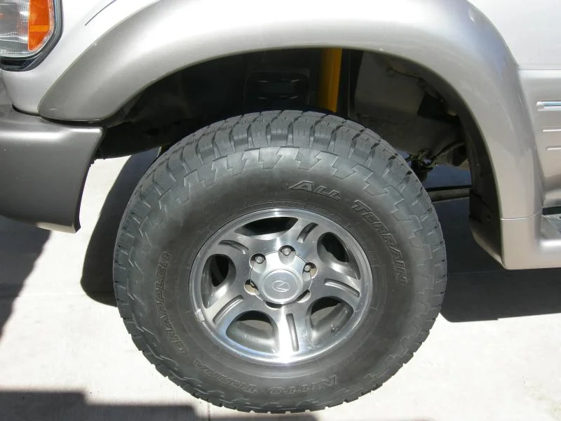

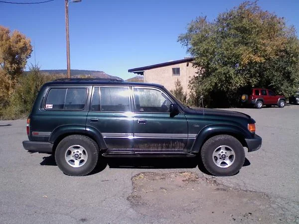

295/75r16 is the largest I'll run without a lift. They will just barely touch the top of your rear wheel wells when fully stuffed. If you lift your truck 2.5" or less in the future you should still be happy with the size.
I'm very happy with my Nitto Terra Grapplers. Quiet, good in the snow, balanced out well, affordable. Standard AT performance off-road.
Here is a pic with said tires without a lift. Hope this helps.
Edit: My spare fits no problem. But rubs a lot off-road as it sits pretty low. I have not tried a bike rack into the receiver but none of my trailer receivers have interfered with the spare. I have an OEM receiver hitch. Speedometer is off by 6%

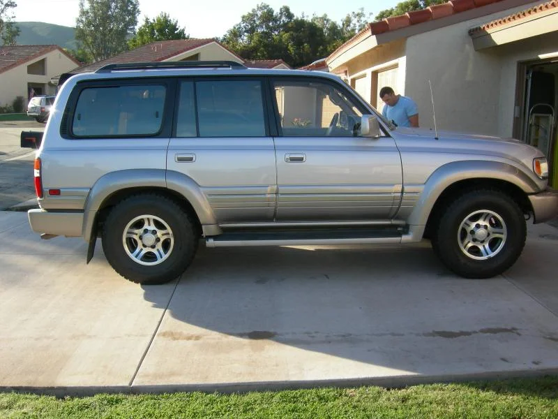

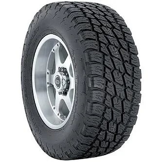

a better look at the nittos

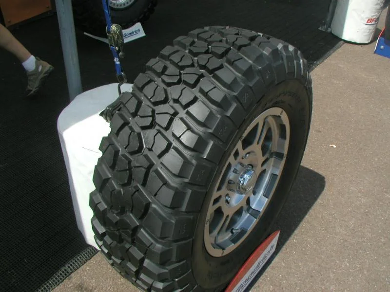

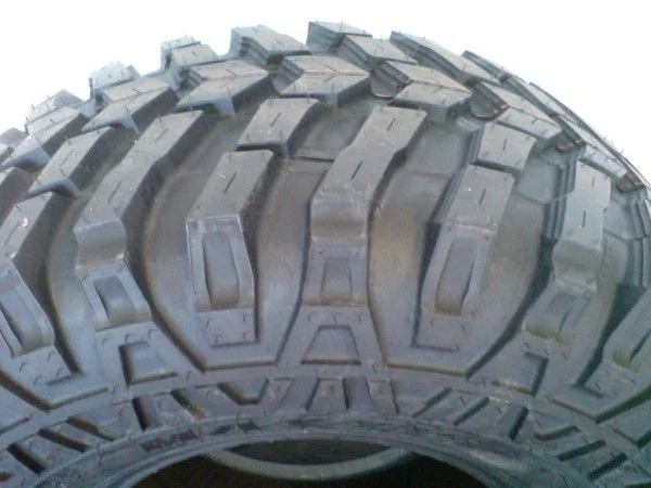

a better look at revo's

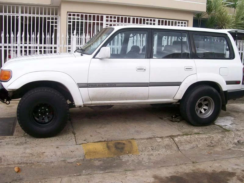

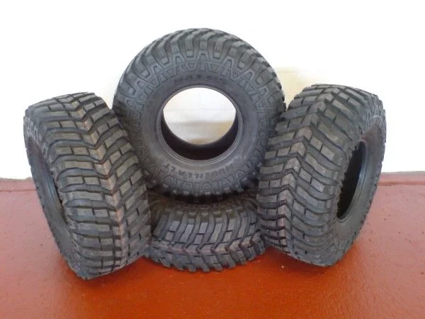

This is what I just ordered through Costco 33.12.50 X15 BF Goodrich Mud Terrains KM2, stock height, gone off road without problems. I was offered the Mudzilla but I declined, (bit too aggresive for daily use).

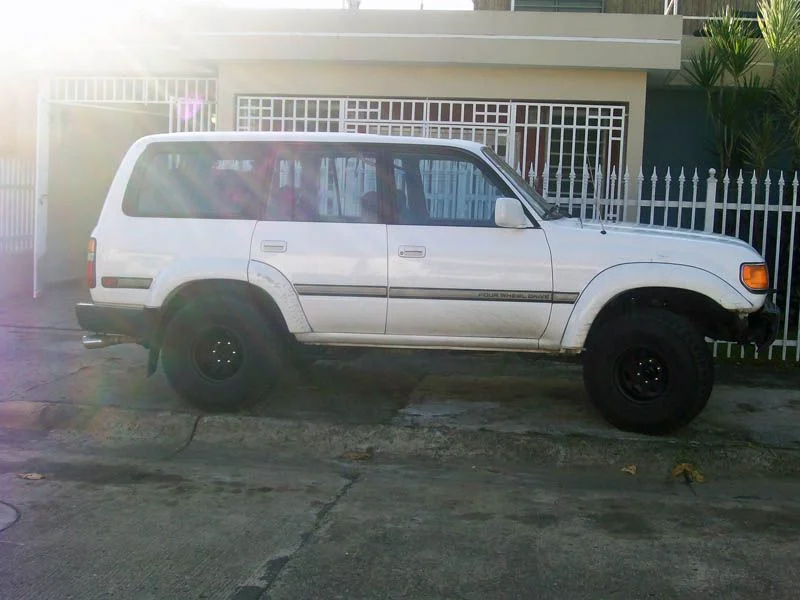

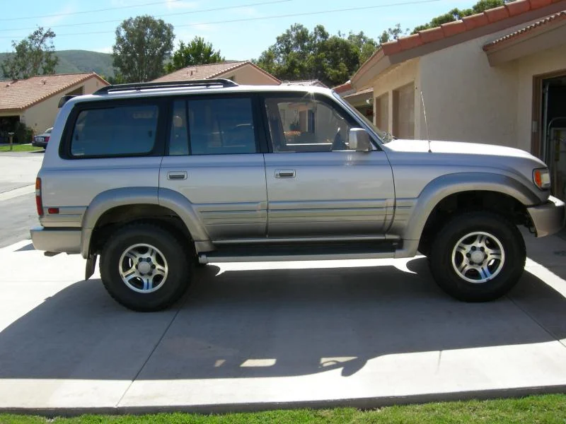

Here's how you 33's will look on a stock truck.

through discount tire they are $153 a piece for 285/75R16's
285/75-16 Nitto Tires

Quote:
I love these tires, on my second set.

I think you would be happy with the 285/75/16 Nittos and the "medium" lift kit from OME. I did the 850/860 combo as many others have on this site. Here are before and after pics of mine with the lift as well as a close up of the Nittos.
