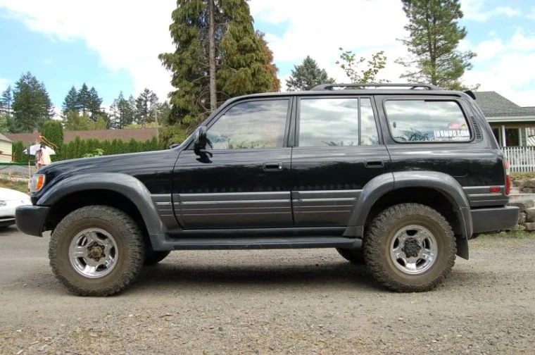

OME Heavies front/rear, no armor, Cooper STT 285/75/16 (33.1" per Cooper specs):
