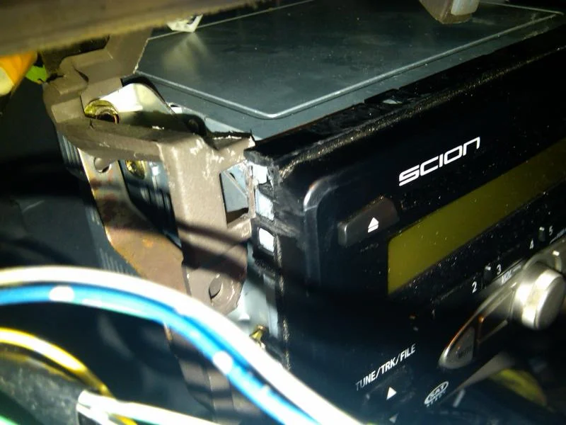

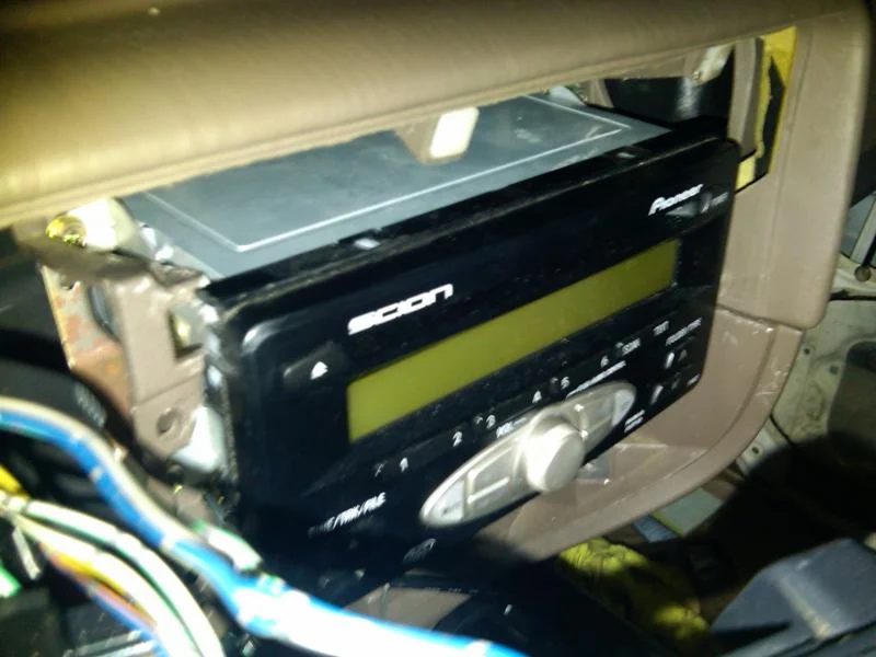

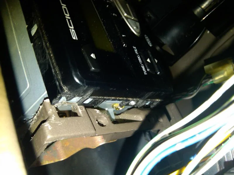

This is not ment to discourage you by any means. I'm just passing on the info so you can see if it's worthwhile.
Anyway, I got the head unit last winter (for what I thought was the right price) and installed it fairly easily. You will need to file down the metal on the stock radio mounts just a little, trim your dash moulding and cut off a portion of the left side of the Scion HU faceplate. (see pics below).
Keep in mind that your display will be orange or at least my 1807 is. It bothers me but I have dealt with it. The LEDs in it can be changed by someone with the know how for about $40. I can dig up the guys e-mail if anyone is interested. Also, these don't allow direct IPOD plug in or functionality along with SAT. Some Scion HU's do just not the 1807 & 1804, that I know of. (You can get a harness that allow for the sound to go to your stereo system but it will not charge your IPOD or allow you to use the HU to select music that I am aware of) I think that takes the place of the SAT in the back of the HU.
If I had to do it again though... I would have bought a nice aftermarket headunit. because to do it right, it could cost you as much as $250-300.
