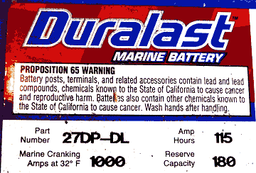

Anyone use a marine dual purpose lead acid battery?
Any thoughts on this $69 battery to use as main/only battery? (Edit: price went up this past week to $79)

You usually get what you pay for.
Interesting specs. Interesting how they are getting that many amp hours and that much reserve capacity for that price. Something has to give to be nearly $200 cheaper than the Die Hard PM-1 and have similar specs.
One thing that's interesting is that the CCA is measured at 32*, which means it'll be less at 0*. The PM-1 has 1150 CCA at 0*.
I wonder how physically big it is and how much it weighs.
My guess is that it uses more thinner plates to push out that much power with that much reserve capacity...the problem is that it won't hold up very well if that is the case. Thinner plates don't do well when jostled (like, say, bouncing around on a lake....or on rocks). They also tend not to last as long as the plates flake when they're bounced, and if too much material collects at the bottom it'll short out the plates it touches (rendering those plates useless, and reducing your capacity and CCA).
If you just need it to get by for now or a street queen, I'd say go for it. If you want to off road for it, I'd say pony up the cash and go with the Sears Diehard PM-1 or PM-2. Those are the best bang for the buck batteries I've been able to find so far in all my research.
I put the PM-1 in my truck and wouldn't do anything else if I needed another battery. The PM-2 will go in the truck when her battery dies (will be a while yet, it's only a few years old). The PM-1/2 are very well built and have great specs, they will hold up extraordinarily well. When I'm out in the middle of no where I want a battery that can hold up to whatever I need it to do, and I'm happy to know that I have a battery I can weld off of if I need to.

Most auto batteries are designed for CCA and not for longevity, durability, or reserve capacity.
Deep cycle batteries are generally designed for reserve capacity and longevity, but not durability or CCA.
The nice thing about the Marine batteries is that they tend to be an intersection of all four things.
The fact that it was heavier than a standard starting battery is probably a good sign as it's an indication that it's either got thicker plates or more of them. Unfortunately, without cracking it open you can't really see how it's designed, and more than one battery which is labelled for a particular use is simply the same battery design with a different sticker on it.
If you've found some good reports on it, then by all means go for it and report back.

It looks like 800cca at 0*. The numbers look pretty good - especially out of a Group 27. The only thing that would turn me off is that it doesn't look like it's maintenance free and the 1 year warranty (3 yr total). Apparently Duralast is made by Johnson Controls. I just bought a group 31 Interstate (also made by Johnson Controls).
The price is right. Somebody needs to be the guinea pig . . .

This battery was at Autozone. I wonder whether this battery will put any strain on the alternator or components, like will it take and feed power like a pure auto battery?? Are boat electrical and charging systems the same as a car/truck?

charging systems are the same. no worry.

As long as it has enough CCA to start the rig, no problems.
If it has very low CCA (like some true deep cycle batteries do) then it can be hard on the battery. No strain on the alternator or other components though.
This particular one should be just fine.

if the CCAs are there, then it seems to me that you're probably better off in general with a deepcycle than a regular for offroading apps if it involves anything like fridges, lights, winching, etc. Besides the DC capability, I have the impression they are just more rugged all around. I switched to one myself (Costco) and so far so good.

What do you do with the extra terminals on the marine type battery (if you're not using them), like cover them with some silicone goop or just leave them bare?

You could smear some dielectric grease on them or get a battery terminal cap for it.
I wouldn't worry too much about it.

from what i read if your replacing your starting battery with a marine battery, you want to spec the deep cycle battery with 20% more CCA's then what you would normally use. so if Mt. T said you need a 550 CCA battery for your cruiser then you would want a marine battery with at least 660CCA to provide you with the correct starting amprage (to prevent shorting the live of the battery). So if you going with a 1000CCA battery you should be more then covered and should not have any issues running your factory accessories and an occisional winch or fridge. if you plan on running many items and a high power AMP or two, or heavy winching on a regular basis you might consider upgrading the alternator.

I bought it, but the price had gone up in the past week. They had just forgot to change the price label when I looked at it yesterday so he gave me 10% off the new price of $79 today. I also asked the salesman for a fresh battery (he had two in the back room) as the ones he had on the shelf were eight months old. For grins we checked the voltage of both; the old stock new battery was at 12.4 volts and 77% capacity, the fresh new battery was at 12.8 volts and 100% capacity. When I got it home I put it on my smart charger and it read 12.8 volts, 90% capacity, so charged it for about 5 minutes at 2 amps to bring it to 100%.
Here are the specs on the batteries (all Autozone Duralast Group 27):
New (current) Duralast Gold 750CCA 135RC wgt 48lbs
Nine year old Duralast Gold 725CCA 150RC wgt 51lbs
New Duralast Marine Dual Purpose 770CCA 180RC wgt 55lbs
For comparison we weighed one of their Valuecraft batteries of similar size; only 38lbs!
Interesting how the RC goes up with the weight, more lead I guess.
One thing is the short warranty; only one year full replacement then two more years prorated. I'm hoping that the short warranty is more due to the abuse these take when used as a marine/trolling battery than anything due to the construction quality?? Time will tell.
To weigh the batteries I brought a digital bathroom scale from home (and got it back without the noticing); all the employees checked their own weight while I was there.

Regular orientation Group 27 (not 27F); the positive terminal is on the right rear or left front if you turn it around. Autozone's website says this Marine 27DP-DL has 90 Ahr, 800CCA, 180RC. I figured 770CCA by multiplying 1000MCA by .77.

well, I ended up buying another Costco Kirkland group 27 dual purpose (starting and deep cycle), and not the Duralast. Both made by Johnson Controls as far as I know.
Reasoning:
- it has 115 Ah vs the 90 of the Duralast. To me that's important cuz I'm running a fridge on a 1 battery system. 30% longer for the fridge is a big deal to me.
- the CA is 750 vs the 1000 for the Duralast, but I'm rarely at low temps and the same battery in my 80 can easily start the engine many times in a row even when seriously depleted. I think the 80 does not require a lot of power to start when in good condition. I'm a wuss, I like balmy weather for my wheeling... Plus a cold feels better when it's not freezing outside
- the same battery in my 80 suffered some serious travails when I did quite a few tests to full depletion. Looks fine so far.
- it's $71+tax vs the $89+tax of the Duralast. Pretty inexpensive in the grand scheme of things.
Basically: higher capacity, sufficient Cranking, withstanding abuse, a tad cheaper. Looks good to me.

E9999: Amp hour versus reserve capacity confuses me a bit. Like your Costco battery will produce about 5 amps for 20 hours, versus a 20 amp draw for 180 minutes (the Duralast Marine DP), if I got it right?? Seems like the higher Ah rating will allow a lower amp draw for a longer time period, but the higher RC will allow a higher amp draw for a short period? That seems to go along with the differences in CA. My final price was $77.90, but that was with a 10% discount. Sounds like we both got what we needed (no fridge for me, yet). We'll have to bring this thread back in ?? years to see how the batteries performed over time.

I'm sure there are many folks who would be be better served by the Duralast. Especially in colder climes. The CCA is pretty good.
the RC is the number of minutes it can deliver 25A before it's pooped.
Yes, Ah seems to be more an overall picture of the capacity for low amps.
RC is moderate Amps
CA is very high Amps
check out Jason's nifty chart on discharge rates in my current thread on winches in the recovery section. Interesting.

IIRC Amp Hours can be measured in several ways. It's one thing manufacturers do to make their specs look better.
Like Duralast measuring the CCA at 32* instead of 0*.
I'm sure
No, there are actually several standard definitions: M(arine)CA or CA which is at 32F and C(old)CA which is at 0F, and IIRC another one around 80F, H(ot?)CA.
It's actually not bad, you can get a pretty good idea of what performance the battery is capable of, with all these numbers (assuming they are truthful).
