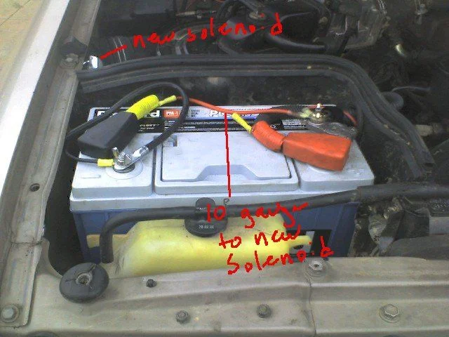

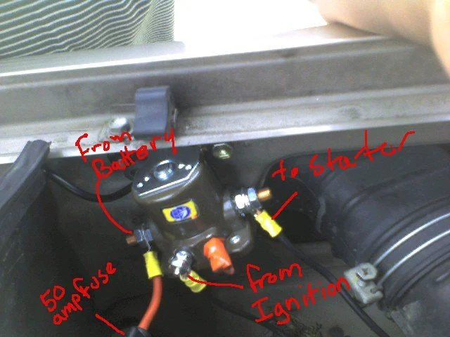

I think I have finally fixed my intermittent start problem, hopefully this will help you with yours. I found this thread from last year:
http://forum.ih8mud.com/80-series-te...t-thought.html
which basically says that the stock ignition wiring degrades over time, and that the intermittent start with the click at the starter might occur when there is not enough power to activate the solenoid on the starter. The suggested remedy was to add a new solenoid with heavier guage wire going to the starter solenoid.
I had already replaced the starter, battery, battery cables and grounds, so the ignition circuit was my last hope.
I bought a 50 amp fuse, an ST 81 starter solenoid switch from NAPA, and some 10 and 12 gauge wire with connectors. I ran the 10 gauge wire through the 50 amp fuse to the new solenoid and from the new solenoid to the solenoid connector on the starter. I connected the ignition circuit to the new solenoid with 12 guage wire.
For the first time in as long as I can remember the truck starts as soon as the key is turned.
there is an extra post on the ST 81 solenoid that is not used so I taped it off. It also grounds to the body instead of a dedicated post. The original thread lists some better options(ST 80, ST 85 and others) that ground to a post instead of the body, but this was the only one in stock so I bought it.
I still have to clean up the mount and wiring but here are some pictures to give a better idea of what I did.
