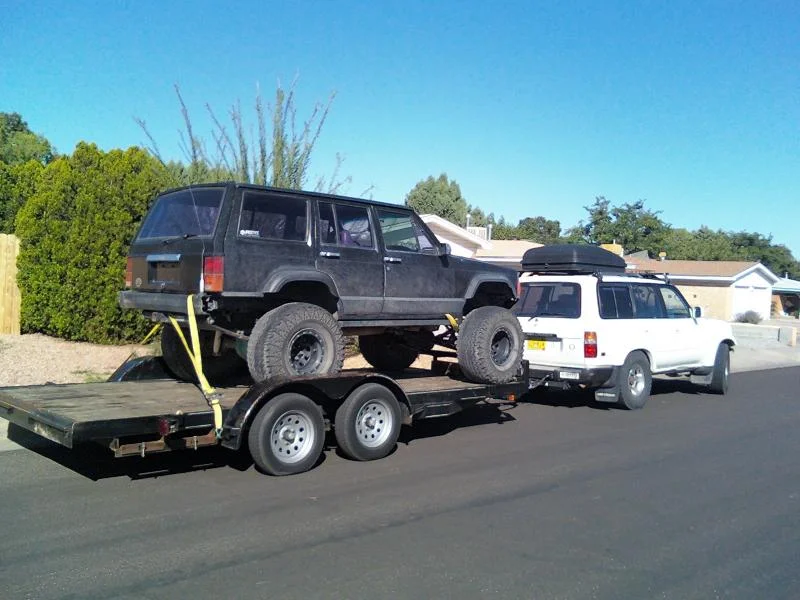

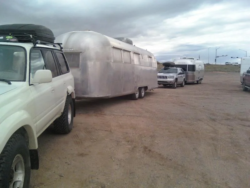

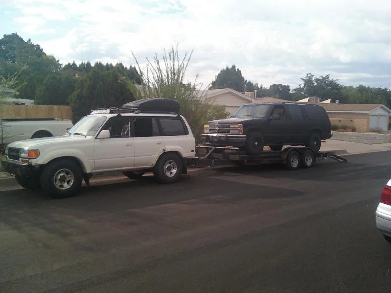

I tow cars with my fzj 3-4 times a week.
I have a 93 (fzj80-4.5 with FF rear). Does great in stock trim.
I have a brake controller and an equalizer I really only use to tow my big ass old 1965 airstream.
I also tow around my play Jeep with 35s all the time with absolutely no problem.(Don't worry, the cruiser follows the jeep on trail runs in anticipation of the inevitable breakage the heep is known for)
I also buy and sell cars on CL to keep my belly full, so the trailer see's plenty of use.
the only thing you may have to worry about IMHO is the rear springs being a little soft for heavy tongue weights. But I have no problem with mine when loaded properly.
PS Mine has 315k+ miles so the suspension is "extra tired"
I've attached some pics of me abusing my rig
1. camper
2. Jeep loaded as far forward as I could put it so I could fit an atv behind it.
3. Fat ass american cargo!

I tow with both an 80 and a 99' cummins. If you've towed with a cummins you won't like towing with the 80. The 80 requires a little more work to keep it steady with that softer suspension and it definitely can't match the power of the cummins. That said, I have almost 200,000 on my 80 and everything runs amazingly. We replaced the tranny on the cummins at 120,000 (automatic). If you aren't towing a mammoth load, go with the 80. You will get a killer trail rig that is super cabable bone stock and as you said earlier, if the 80 doesn't fit your needs, you could probably sell it as easily as you purchased it. As a daily driver the 80 is a smoother ride and I think, more fun to cruise around in. Plus the ladies love the 80's...cummins aren't as impressive.
(I based this on the assumption that you would not be buying a new cummins.)
