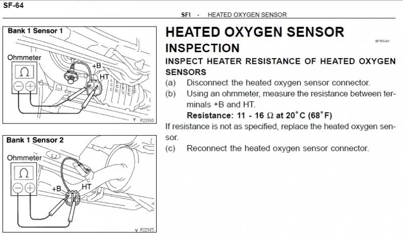

Quote:
Originally Posted by kup99 View Post
P0130 -- O2 sensor malfunction (Bank1 Sensor 1) and P0133 -- O2 Sensor CKT slow response (Bank 1 sensor 1)
P0130 can be caused by a problem with the O2 sensor (or wiring) or a problem with the fuel trim (as per my FSM).
P0133 only lists the O2 sensor itself as a possible cause.
xWhatever on checking the wiring, then replacing the O2 sensors if the wiring is good.
(From my '97 FSM, but should be the same idea on yours.)
