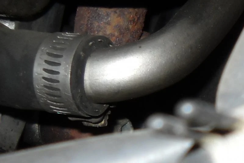

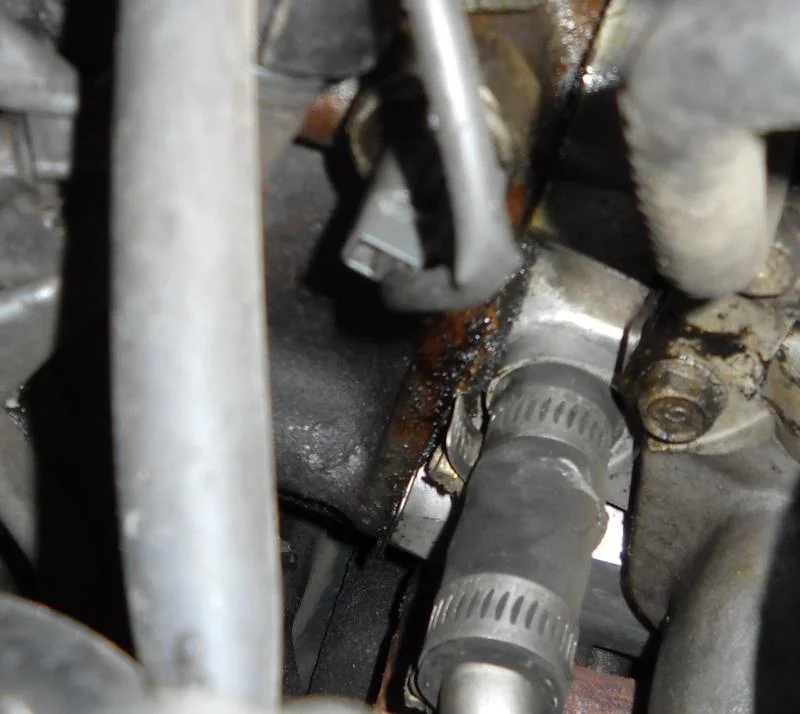

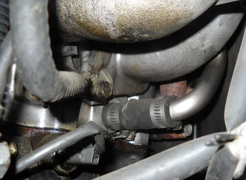

Hello!
Today I did some photo to the Pesky Heater Hose from my Cruiser and PO all ready replaced the hose, but I need to do again because of showing signs of leakage, and bulging ( I have 215000 miles on board), and I am wonder if you guys can say from my picture if the wet spots are from PHH or something else that I need to worry to.
Thank you!

The last pic looks ugly below the upper clamp, on the right side. I wouldn't waste any time getting to that, and definitely wouldn't go far from home.
Hard to say if the dampness is the PHH, but in any case it needs a new one. Find some silicone hose and constant torque clamps.

Hey Cowboy, you may want to do your PHH while doin' you HG. Look like a leak. There's also a wet spot on you EGR pipe connections.
In your 1st pic, that wet, oily bolt above the PHH is, I believe, one of the retaining bolts to the lower intake.
Much easier to get the PHH w/ the head off.

That "crumbled" look is just not good on a hose, especially one that catches so much heat. Time for a replacement.

I assume the heat is from the proximity of the EGR pipe. Has anyone wrapped the pipe before?

If your heater hose were not leaking coolant right in that area I'd say high probability your HG is leaking. But with that bad hose right there and various air movements from the engine fan and vehicle movement it's obviously not good practice to call it a HG. I'd fix the hose, clean the area well with some spray in/soak/foam degreaser, then check it again in a month to see if you still have coolant in the head/block seam. If so, THEN I'd call it a HG leak.
Also, those are some of the best close up engine pics I've ever seen here. Mind sharing what you were using to get in there? I have a hard time getting my HAND up there, much less photographic equipment!!

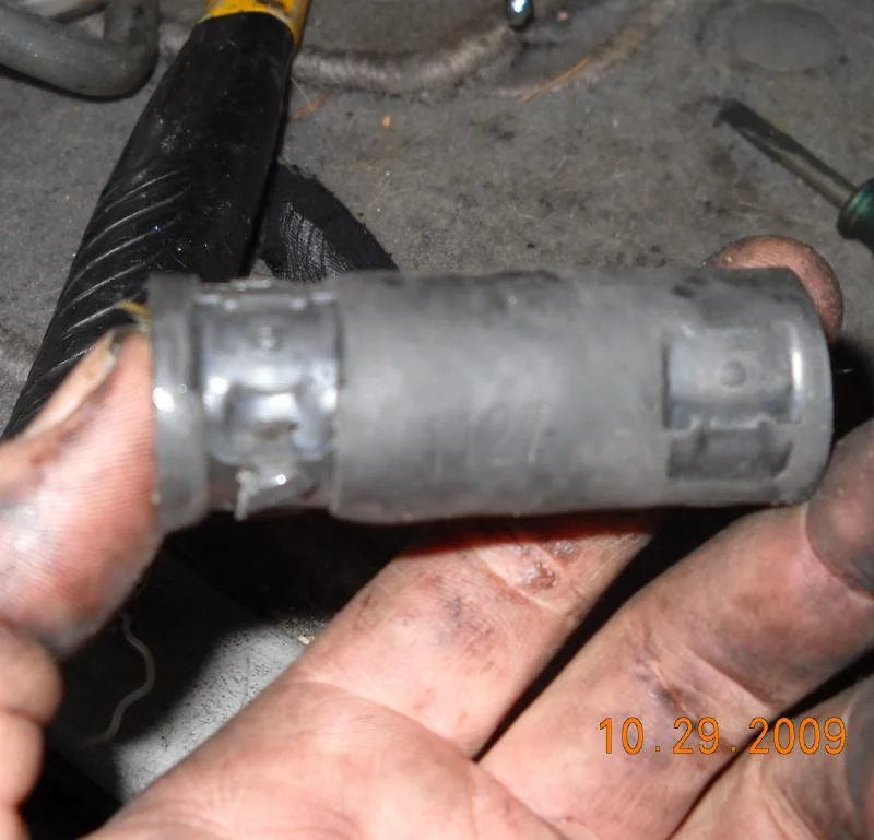

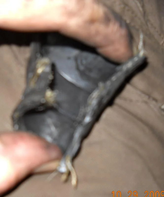

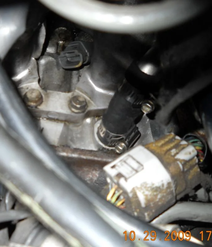

I hope the PHH to be the leak, is looking like who did this job before don't tied to strong the left clamp . I still have some bad leaks, steering and engine and I am looking to post the pictures soon for more opinion on my new problem .
Otherwise, the hose was in good shape in despite that bump on the hose end. Check on my new pics, this time one is not good quality.
Hahahaha! Is looking like I have some high experience in something to around here. Well, I use a basic digital camera the cheapest that I found a Target, is a Nikon and I have few thousand pictures until now to get to this quality pictures. The secret is get the camera where you want to do the photos and start fire up like you have a gun in your hand or you are in a modeling studio with a model .
