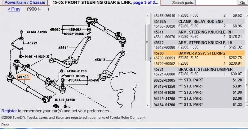

Ihad to remove damper and it turns out that previous owner used wrong bolts or nuts and in process screw up threads on bolts. Where do you get replacement since It appears they only come with damper itself. (my damper is OME). Can I buy them separate? Where would I get them?

The OEM ones are integrated like tie rod ends so they won't work for you. The OME ones are a seperate stud with the proper taper and threads on both ends. You might have to call ARB USA and see if they can help you out.
