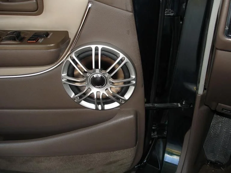

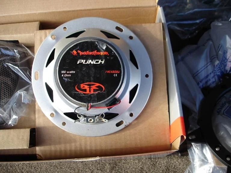

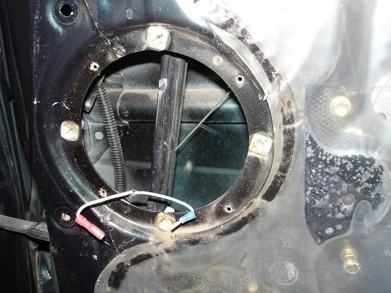

I just replaced the front door speakers with Polk db651 6.5" speakers and the difference in sound is very noticable. I ordered 2 pair and plan to put the other pair in the rear doors soon.

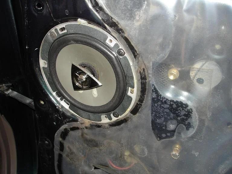

When I removed the door panel, I realized that the PO replaced the front door speakers with the CD player - maybe that is why they didn't sound as bad as others have commented. So I debated whether or not to replace them at all, but after taking the driver side speaker out and hooking up the new speaker, there was no comparison.
However, what I learned is there is another front speaker option for those that want to retain the factory grills. The speakers I removed are Rockford Fosgate Punch FRC4206U and they fit behind the front door panels without a problem. The metal frame that holds the window inside the door seems to be the limiting factor with speaker depth.

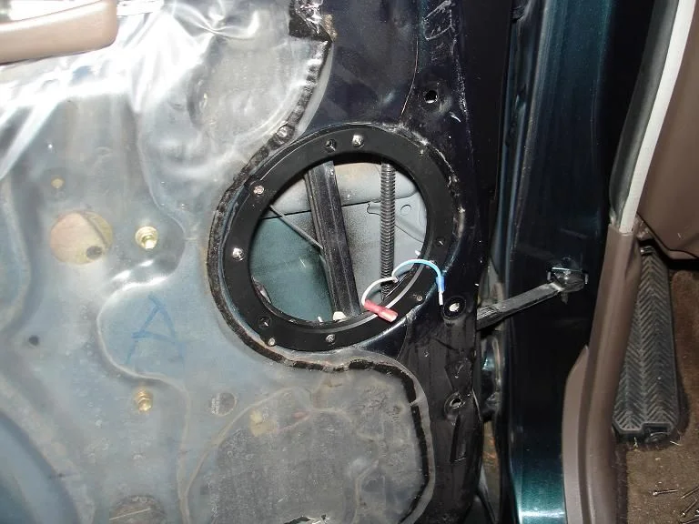

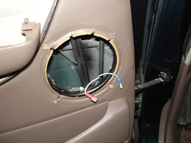

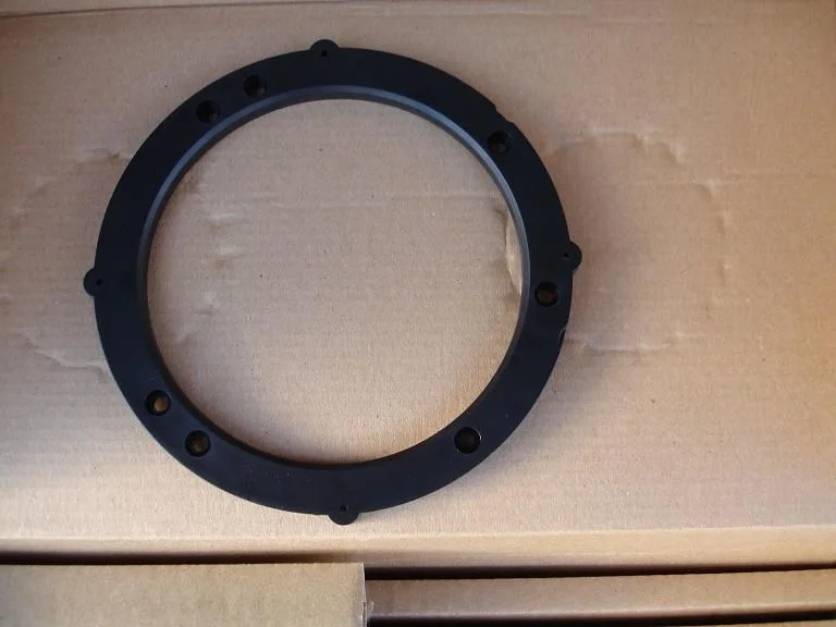

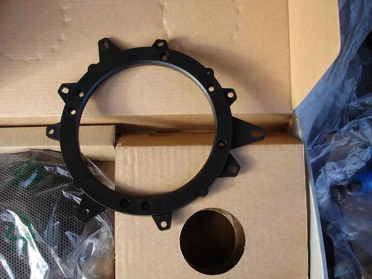

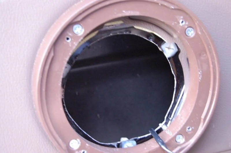

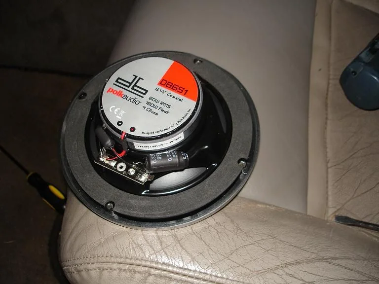

I selected the Polk db651 because the mounting depth was fairly low. I debated between these and the db651s, which are shallow mount, but found out that shallow mount refers to how much of the speaker sticks out above the mounting plate. Since I was more concerned with depth inside the door, I went with the regular db651. I don't mind the speakers being visible (it is a 15 year old vehicle), so trying to find a very shallow speaker was never a concern because the selection is very limited and the sound quality suffers a lot.
First, I removed the door panels and the speakers. I checked the mounting depth and knew I needed to space the speakers out from the door some. I used the supplied mounting bracket and cut off all the extra tabs. Next, I taped the speaker bracket where I wanted it and drilled 4 holes using the bracket as a template. I attached it to the door using 4 #8 x 1" stainless screws.

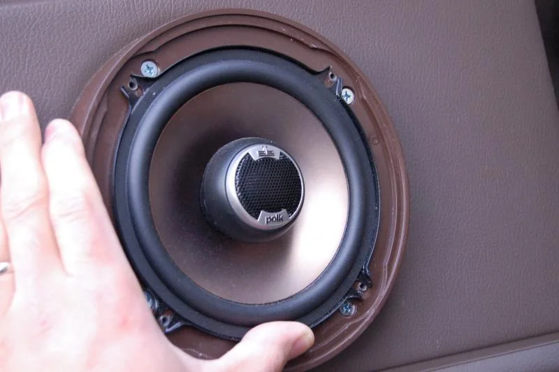

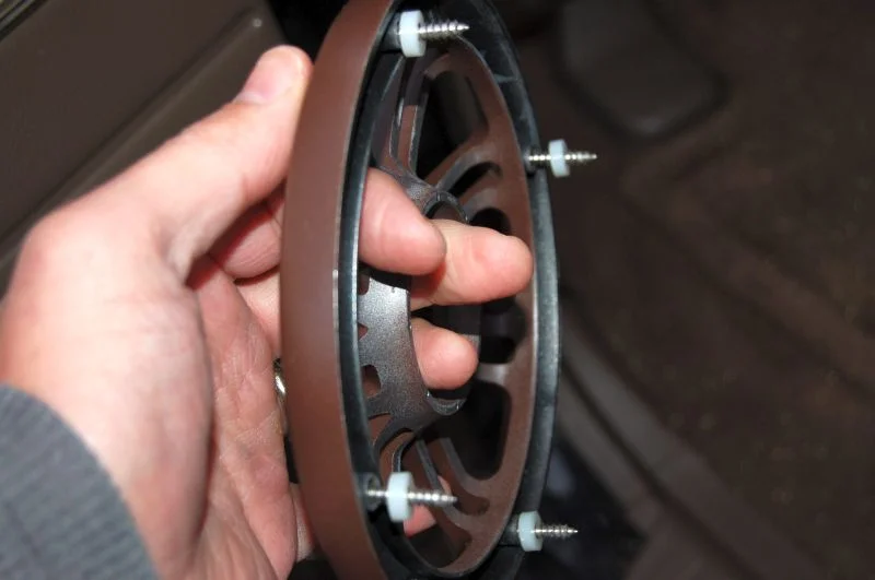

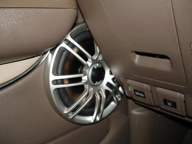

Then, I put the door panel back on and made sure everything lined up. Using the supplied mounting bracket allowed me to create a spacer between the door and the panel to give me a little extra clearance. It also gave me a solid surfact to mount the speakers as I didn't want to just screw them into the door panel. I used the 4 speaker mounting holes as a template and drilled 4 small holes around the speaker opening in the door panel. This gave me a template to mount the speaker and made sure I was securing it to the bracket in the correct places. I used a Dremel to smooth out the edge of the speaker grill that rests against the chrome accent strip on the inside of the door and provide enough clearance so the speaker sits flush. The amount of material removed from the speaker grill was minimal. The mounting bracket is mounted to the door and the speaker is mounted to the mounting bracket (the way it should be) through the door. It feels very secure and offroading shouldn't be a problem.

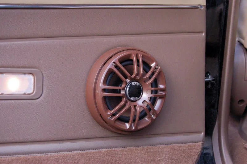

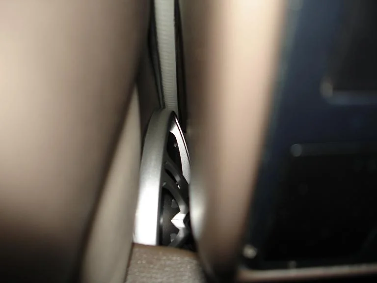

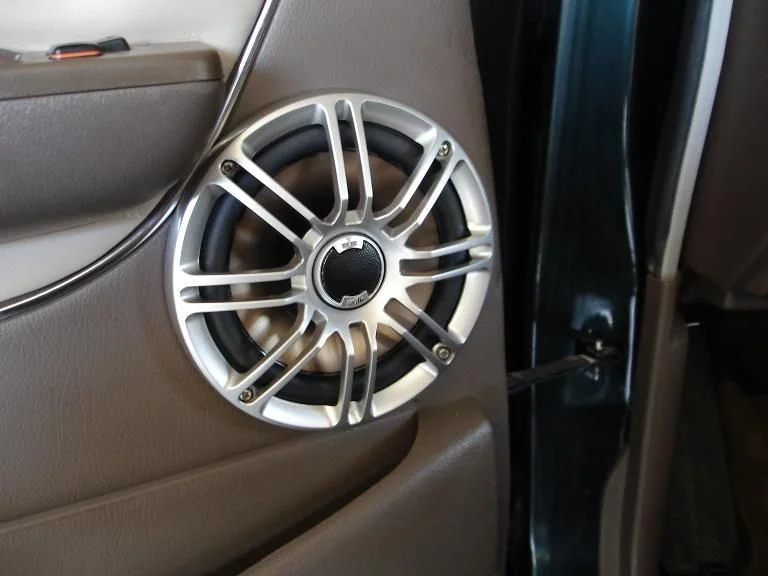

A few more pics of the finished product. There are no clearance issues with the dash and the difference in sound is amazing. The 6.5" speakers put out a lot more sound than the 5.25" versions of the same speaker, so I plan on installing my other set in the rear doors soon.

Doesn't look bad compared to most of the setups without factory grills.
Good job

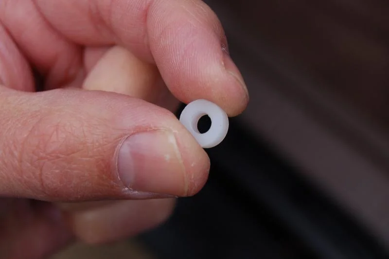

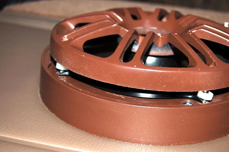

The rear install requires making the speaker hole a little bigger in the sheetmetal. You can use a jigsaw, with a metal blade, it is very simple. The 5 1/4" speaker is actually bigger in the wrong places, than the 6.5" which should fit easier.
The 5 1/4" did not come with the spacer like the 6.5" did. I bought a $15 spacer (now I remember, that is why I bought the brown spray paint, because the spacer is black and doesn't look right). And attached it through the door panel and into the sheet metal with sheetmetal screws. Then I attached the speaker to the spacer, I used a small nylon spacer/washer to make sure the grill and speaker were snug when screwed to the spacer.
You may not need the external spacer with the 6.5", but if you do, the same spacer fits 5.25" or 6.5", so you could mount it exactly the same if you want/need to.

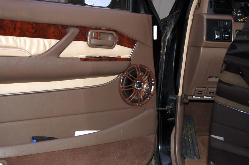

Here is a pic of the front door, with painted grill:

The thread says that 96 & 97 owners have about 1/2" less room to play with because of the extra thickness of the door reinforcement.
There is a picture of the inside of the door in post #7. It is hard to tell from the perspective if the reinforcement bar inside the door is larger than what is shown in this thread. This is probably only an issue if you want to retain the original grills.
Compare the inside door pic (first pic) from post #7 to the second pic in my first post. The door reinforcement is there on my 95. What you are seeing in post #7 is the metal window channel, which is present in mine as well. You can see the door reinforcement behind the window channel in both pics. If you compare the width of the door reinforcement to the width of the window channel in both pics, it looks like they are the same. Judging by this, I would say the changes apply to the 95-97s and these speakers should work.
