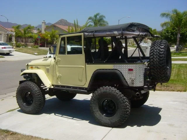

Flat towing my 40 with my 96 Fzj80
I know this has been discussed before and I did research but did not find too much info specific to my situation.
I wanted to get opinions on whether or not it is unsafe to flat tow my specific 40 behind the 80? From what I have read and seen I think it can be done safely. I am going to give it a try and set it all up to see how it feels soon here. My 80 is bone stock, but I plan on adding an oem suspension 850&863 springs as well as a 4x4 labs rear bumper. My understanding is that the tow rating is 5500 pounds in USA and more like 7k+ in Aus. I have flat towed it before with a new tundra but well had to sell that, it flat towed great then, only trouble was when I was in windy roads. I have a surge flat tow braking system seen here:
ReadyBrake Supplemental Brake System for Towed Vehicles - Night Shift Auto
I used this system on my tundra and it seemed to work well. I tested it by emergency braking on open road and it helped keep the 40 from swaying when braking hard.
Keep in mind I don't plan to tow much at all. Maybe one time a year on long journeys. I would like to drive the 80 with the 40 in tow out to places like Moab OR the rubicon from San Diego as the 40 is just not comfortable on long drives. Anything local / within 4-5 hours I just drive. That and I don't expect to go fast, would take it very slow. Comfort and safety are the main issues here. I also plan to only keep it to the interstate, for the rubicon for example I would drive the 5 all the way up to near sacramento, leave the tow rig with a friend and drive the 40 the rest of the way. I have learned that flat towing on mountain roads is simply no good.
Not sure what my lifted 40 weighs, I suppose I could get it weighed at one of those truck scales on the freeway? I have read that a stock 40 weighs in near 3500? so can't imagine mine is more than 4500? A couple pics of the 2 trucks are below.
thanks for the help and opinions.
