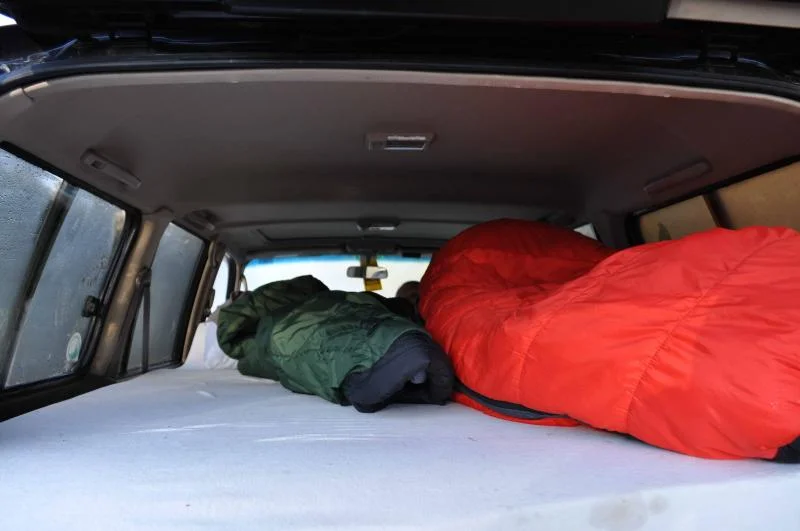

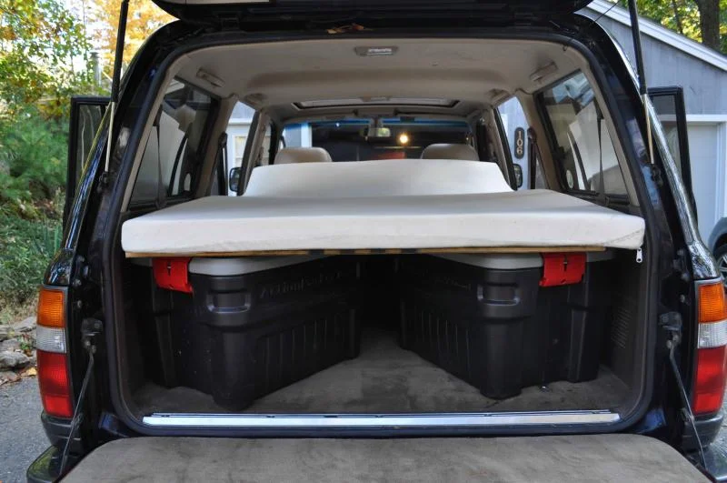

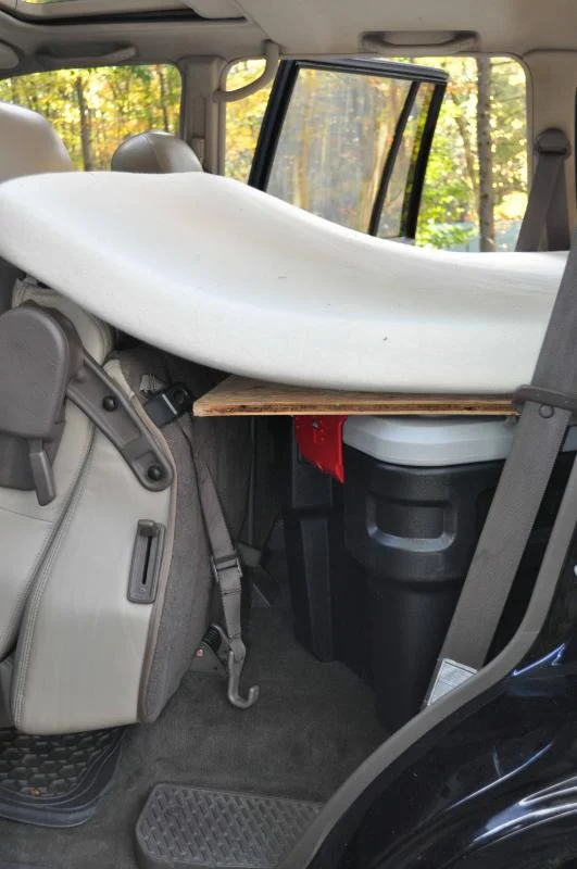

Looking for a quick sleeping platform for a recent trip, I wanted something that was cheap and quick.
This setup is just four sections of plywood (16" x 4') that can be placed atop bins.
The plywood is stored between the bins when not in use.
The bins are Rubbermaid "Action Packers"; they're pretty sturdy and have locking lids (sourced from Amazon.com with free shipping).

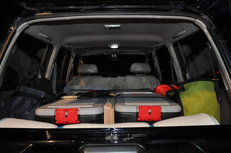

(continued from above)
As I see it, the advantages of something like this are:
(1) It's cheap; especially if you already have the bins.
(2) Since the plywood is lashed down between the bins when not in use, you don't have to figure out a nice way to tie the platform to the truck while wheeling or driving around.
(3) It's not much of a hassle to setup and remove. It really only take about 3 minutes.
(4) Unlike most drawer systems with platforms above, the storage is accessible without getting out of the vehicle when the bed it not in use.
The cons are:
(1) Your bed isn't always setup.
(2) You have to make sure you don't need anything from the bins before you make the bed. They can be slid out fairly easily, though.
