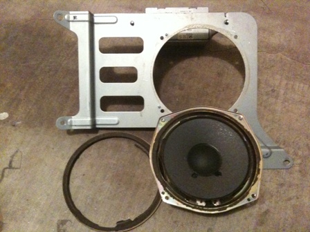

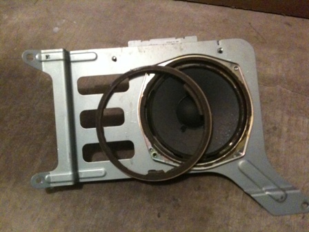

Not Factory....But it does have some BASS!!! I know the carpet is ugly..
