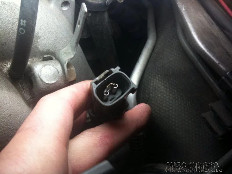

My Try
Ok, this is what I tried!! One step better then a paper clip!! what I would like to know is if I did it right? Thanks!!

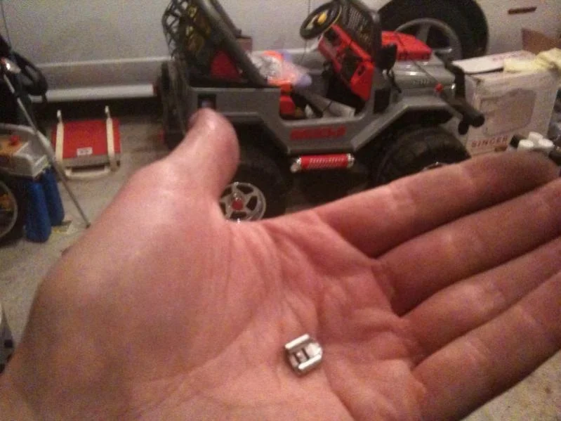

That'll work!
Okay, so I know I promised pics......
Yesterday my CEL came on. I had noticed that since the last time I reset my ECU, the emissions status stayed yellow and never went green, and the emissions chunk wasn't clearing. Checked the code, got P0402.
Since before I had my exhaust done I had reset the ECU several times with this mod in place, and the status always went green (and never threw any codes), I suspect that something in my wiring got goofed up somewhere along the way. If the pins aren't making good contact then the ECU will see slight resistance in the wiring, and will throw a code because the resistance is out of spec. (As opposed to seeing no resistance at all.)
I'm gonna pull it apart and make sure that my wiring is solid. Considering I ran this for over a month with the mod working perfectly (no CEL's and status green), and now I'm getting a CEL after redoing it, I'm guessing that I goofed somewhere along the way.

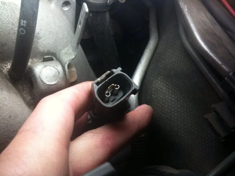

I keep getting the 402 code. seems to stay off for about 100 miles or so, but then it keeps coming back on me!! I haven't stopped the flow with the BB's yet, but would that really matter since the sensor is not connected? I'll also double check my wire/clip piece!
