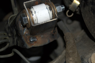

Thanks to Kaoscruizer who found some bushings that should allow the lower rear mounts to bolt right in.
http://www.summitracing.com/parts/EXP-68070
Quote:
Pro Comp Suspension Systems 68070 - Pro Comp Shock Bushings
Bushings, Shock, Polyurethane, Black, Hourglass Eye, 1.470 in. Long, .737 in. I.D., 1.070 in. O.D., Pair
I just ordered a set, and will report how well they work.

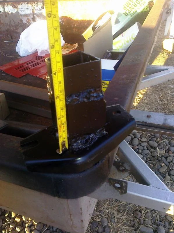

For the rear there's a basically bolt in option for the OME L length shocks. Pro Comp offers their model 926510, which is 15.56" min to 26.79" max (11.23" travel, slightly longer than the OME L's), and is a stud/eye combo. Even with the medium height lift I think I'd bolt these in, and get a lot more cycling out of the rear.
There's a shorter option, the 925553, which is 15.22" to 25" (10" travel). This would probably be a good choice for 33's as they'll tuck better. They're an inch shorter in overall length than the L's, but that's still longer than the standard.
The longest option is 929510, which is 17.09 to 29.77 (12.68" travel). I'm not sure how you can fit that without adjusting the bump stop down, but if you had the bump stops adjusted for the L's they'd probably work just fine. And at 2.68" more length than the L's, you'd get quite a bit more travel in your motion.
There are no good options for bolt in for the front. The closest you can get is 925553, and you will need an adapter for the bottom mount, which loses you about an inch. You may have to adjust the bump stop even with that short of one, and the range isn't that great (10", an inch shorter than the L's). It's certainly an option, though.
Just for reference, I ordered 929508 (12.5" travel) for the front an 932008 (14" travel) for the rear. I plan on making new upper shock tower mounts for both front and rear, and using an adapter in the front for the lower mount (hence the shorter shock).
The rear does have more room to go up, especially if you have a body lift. It looks like I could go up between 4" and 5" from the stock location (the body lift gives me tons more room), though I'm only planning on going up about 3", which should put the min on the 932008's at 15.82" from the stock location. Fully compressed I'm sitting at 16" between the bottom of the upper shock mount and the center of the lower shock mount, so that should give me a bit of room to play with.
I could probably fit the next longest shock if I went up even further, but I didn't like the idea of having it that close to the body, and wanted plenty of room for adjustments.
My total was $153.96 delivered to my door for all 4. Slee sells the OME's for $186 a pair ($368 for four) not including shipping.

And here's the pics.
Passenger side, from the fender:
Driver side, from the front (notice how much room there is to go up, though you'd have to do a lot more fab work to make it happen):
Passenger side, lower mount. The insert (that keeps the bushing open to 1/2") popped out, so I was forced to go with a 3/8th's inch bolt. I upgraded that to grade 8 and called it good.
The upper shock mounts are so silly easy to do. If you ground it down and shot it with paint, it'd look OEM. You could also cap the top off for a more finished look, though I prefer it open for two reasons, one so you can see whats going on in there, and two so that the box flexes in a little and really pinches the bushing when you tighten the bolt up.
You can see in the PS pics that I have some washers in as spacers, the DS pic was before I had put in the spacers.
My only complaint with the Pro Comps is that the lower bushing is supposed to be for a 1/2" bolt (the upper bushing is for a 5/8" bolt, or a 1/2" if you use a spacer/insert), but the insert is a little tweaked and you can't fit it through. It's not a big deal to drill it out slightly to fit the bolt, you just need to be careful not to push the insert out of the bushing (like I did ).
If I were to order another set, I'd order them with 5/8th" bushings top and bottom, without a center insert. You can then get an insert that will step them down to 1/2", I found out today that my local Ace has 'em so I picked some up to use instead of provided inserts.
Still liking the ride/feel.
/me edits
Couple more data points.
1) Compressing these shocks is way harder than the OME's. Maybe I'm just a skinny white boy...but...dang.
2) I gained 1/2" of lift in the front after installing the procomps.

Here is my very ugly new upper shock tower. I got impatient doing it, so it doesn't look nearly as nice as I'd like. Oh well.
As you can see, I went up 4" total, 3.5" to the center of the bolt hole. It's actually at an angle that roughly matches the original shock mount angle, so it's a bit less than that on the other side (maybe 3.75" total or so).
This just barely clears the body, and that's with my 1" body lift. So if you want 14" travel shocks, you're going to have an awfully hard time clearing them without a body lift or spacing your bump stops way down.
The shock I got for the rear is 18.82" at minimum. Since I went up 3.5", that leaves me at 15.32", which gives me about 3/4ths of an inch extra room, which is just about perfect IMHO.
For length I will be sitting at about 29" (from the stock mounting location). In comparison the OME standards are 24.40" long, meaning I'm seeing a gain of about 4.5" (and no lost up travel).
I like.

isn't this mount 90* out?
http://lh5.ggpht.com/_slVHNYKrqfc/Sq...0/DSC_0253.jpg

Quote:
Originally Posted by landtank View Post
Does it really matter?
I've looked at quite a few trucks, and many of them are mounted in that direction. Some are mounted in the other direction (foward/back). I talked it over with the guy who helped me do my front shocks, and he made the good point that there is not really all that much movement forward/back/left/right, the majority of travel is up/down.
While I haven't done anything super crazy flexy, I've gone through some stuff that stuffed the front about as much as you can, nothing contacts or is causing any problems.
It would also be more difficult to bolt it in if the bolt was in the other direction.
