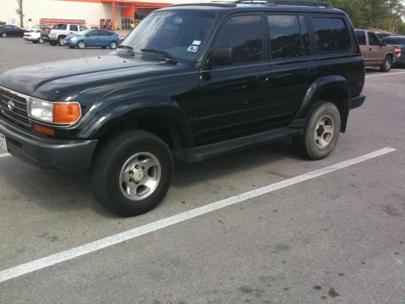

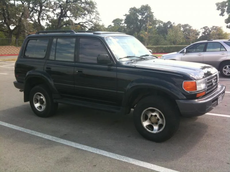

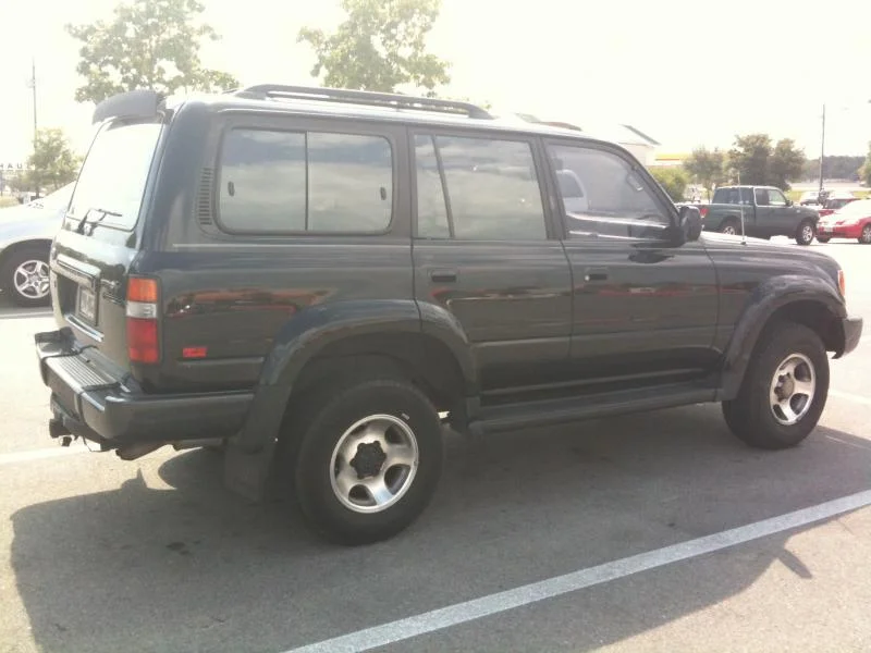

Pictures after the lift kit installation
baktasht is offline   Reply With Quote

Picked up a used set of 315/75/16's and got them put on today. They fit much better. Definitely need some spacers or different offset wheels to get the stance to look better. But getting there little by little:

went to lunch and took a couple more cellphone pictures. I have to say, 35's are a perfect size for the truck. I'm very glad I didn't go smaller. Thanks for the help on the decision Ebag.
It even fit in the parking garage. Got lucky though, we have fairly high garage ceilings here. It barely clears though. I have maybe only 2 inches in some places in the garage. I might have to remove the roofrack to get it to fit in the garage at home though, doubt it'll clear with it on there.
