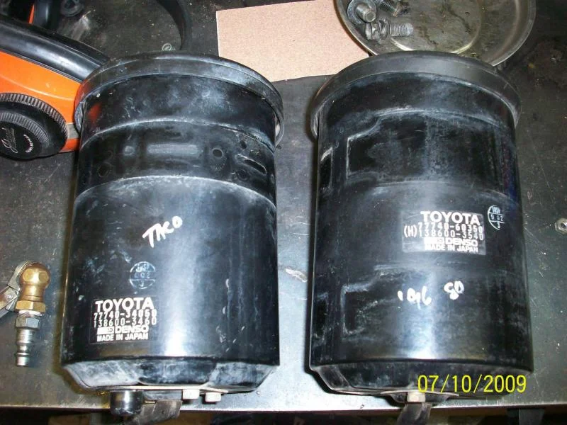

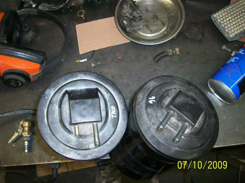

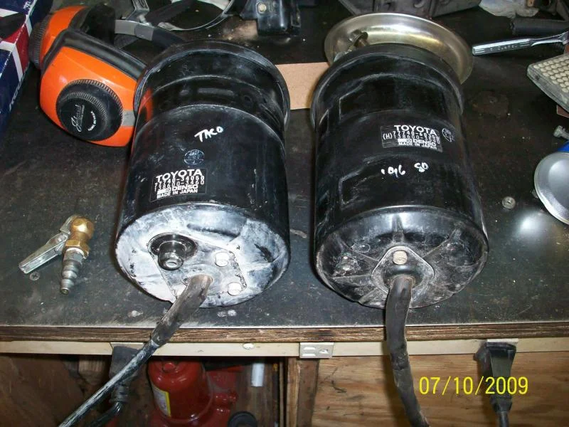

Is it that easy to toast a brand new CC? I thought all they had inside was a spring loaded ball/check valve dealie, how in the heck can that go bad?
Anyway, I found a Taco CC that was the same diam and using that in my 80. I don't have a long term usage report, particularly how the thing handles the main + aux tanks full of gas and wheeling but this maybe an alternative for you.
This is a pretty much a PnP. The top two nipples are backwards and one of the nipple from the Taco unit is tad shorter and skinnier.
Before anyone asks me about the year of Taco, I don't recall. It's been sitting on the shelf for a year or so. Sorry!
Some pics.
