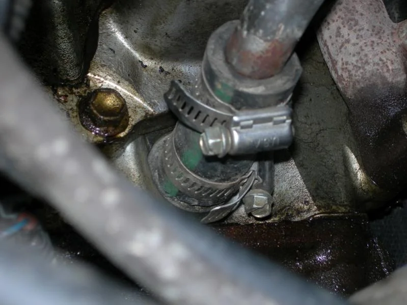

First question is around the PHH. I was gonna just replace this at the same time as all the other hoses since I have it all drained, but it looks like its been replaced already. Any ideas of if this is the gates green stripe hose? (Not trying to be a sarcastic....I recalled some threads around Napa selling a similar hose that really wasnt anything special, but I couldn't find the thread). Worth replacing again? The lower bolt on the pipe is already gone(missing I suspect from last fix).

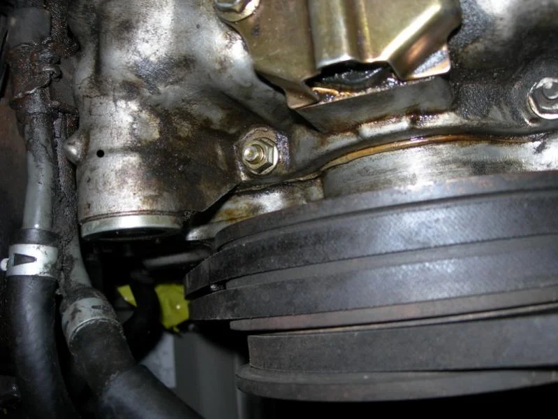

Second question is around the oil pump seal, and if I oughta try and track down a huge torque wrench and replace the seal while I have space with the radiator gone to get an impact screwdriver in there. Seems to be leaking a bit; attached picture was after about 12 hours of cleaning the underside of the cover. Dig deeper into the project or leave it for later?

That PHH looks fine. I just replaced mine with a stock hose when it was done, and the one you have there is beefier.

Corey is it leaking bad after cleaning around that seal? You should be able to see how much is dripping now, If its getting the underside wet, you will have to change it.

I don't care for those clamps, I would consider putting on some constant torque tension clamps, my PHH "kit" from 1fzfePHH.com came with them. I do like having the silicone hose, and knowing I will most likely never have a PHH issue now. Your hose looks fine though.

Cool, I'll look into changing the fan clutch fluid while its out, as well as try and get some of the lined hose clamps for the PHH when I get new ones for the rest of the hoses (glad I dont have to replace it...thats the first bit of good news on this project). Belts are also on the list. And I'll probably end up digging into the oil pump seal since I'm already half way.
