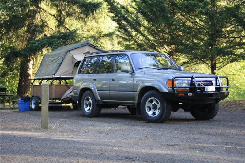

And to offer a little tech to what is otherwise a pretty chatty thread..
This was the shakedown run for the 1HD-FT H151F HF1A conversion ( translation: Toyota 24valve Turbo diesel, 5speed, part time case) I had the engine in and running only 5 days before we left on the trip.
Hwy RPMs higher with the 5spd vs AT. 2550 @ 60mph, but the 24valve doesn't mind the revs. Just takes some getting used to. 285s will help lower the RPMs a bit.
1FZ used to get 280 miles on a tank, bone stock with no gear or anything. Post conversion, this trip the worst I could do with 1400 lbs of trailer, Roof top tent, Engel fridge, Bullbar, 4 people etc was 400 miles on 21 gallons. That was 65 mph between Redding CA and Portland OR over the mountain passes on I5.
Best I got was 497 miles on 20.5 gallons mostly not towing trailer/RTT and more city driving
and 55 mph jaunts around Redding, Lassen, Whiskeytown area.
Great trip, engine didn't miss a beat.

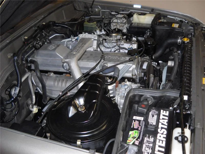

Engine and interior pics!!

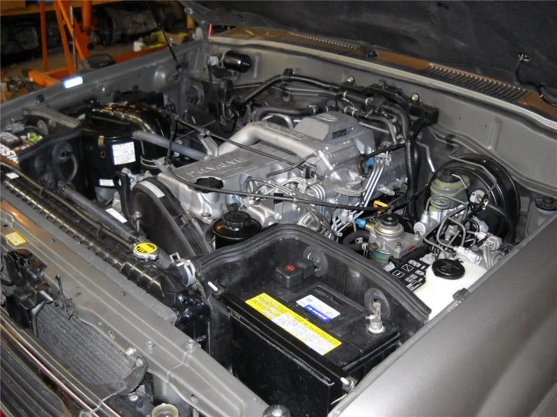

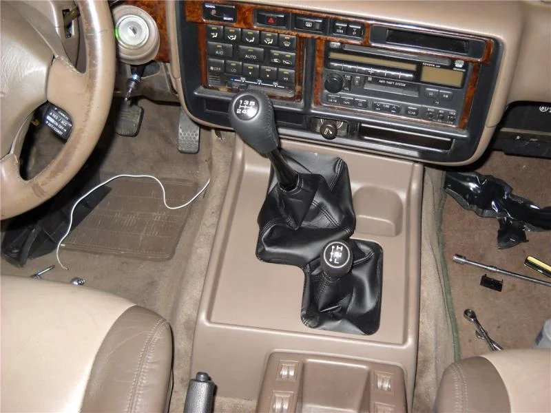

Ask and you shall receive.
Still some loose ends..er wires a the time of the shot, all done now and
yes, ALL the faux wood has been removed.
I am planning to put a thread together with start to finish progress shots and some details.
As soon as I get caught up with stuff that is.

from another angle

That is sweet, really clean...sort of.
