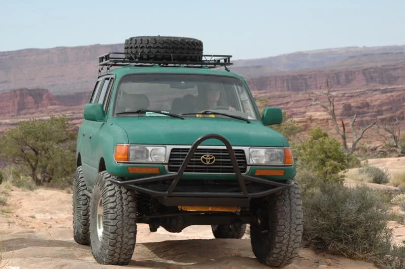

You want Trxus MT's to replace those IROKs. They will be as quiet as an AT, monsters in all winter conditions, and still seriously good offroad in virtually all conditions. In a wet climate, you leave way too much on the table with AT's without saving any material coin.
Plus they look awfully good in a 37 (this is stock backspace, I have them on 1" spacers now)
