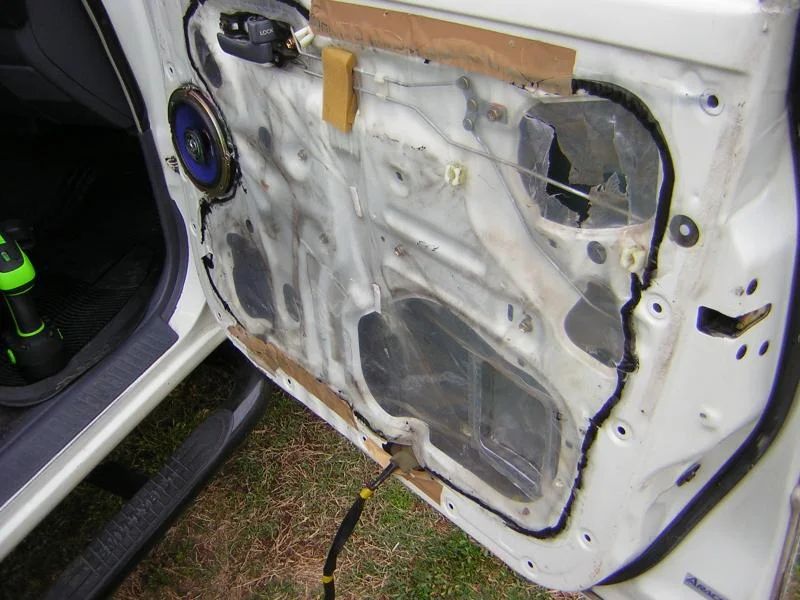

I don't have a pic of the driver's door with panel off, but here is a shot of the ps.
Picture a mirror image and you are looking at the ds.
With panel off, I would check all linkage and see if you can spot any binding points.
Make sure all is clean and clear of anything which might cause a bind.
You may opt to ligntly lube with white grease at sliders and elbows.
One thing to check for: the bezel that fits around the lock/unlock lever may sometimes bind the lever if it is not seated properly. Check that point and carefully adjust the screw mount if needed.
Be careful tightening the bezel screw as it can crack the bezel if overtightened.
