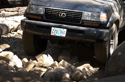

As my 80 is my DD, on road performance matters to me more so than a trail only rig would. I can safely say that the Grabbers have far exceeded my expectation, as I've driven them through everything from dry pavement, to snow and ice, to heavy thick rain.
Previously I had the Toyo M/T's which seem to be the popular tire out here. Frankly, I hated the Toyo's. They did okay on rock, but tended to slip on any sort of a slick surface. In wet/icy conditions I did not like the way they handled on road, and on wet or slippery rock (such as rock covered by dust/sand) they did not grip well.
Since I've had the Grabber's I've ran them through many different types of terrain: Mud, wet clay (IH8CLAY), ice, dry powdery snow (4+ feet deep), wet crusty snow (4+ feet deep), dirt, gravel, sand/powder so fine and slick it might as well be ice, rock.....we have a wide variety of terrain and conditions around here.
My only "complaint" was in snow I thought that they just handled "okay". Knowing what I know now, the majority of that mild disappointment in the performance was because I was running them at too high a PSI (around 20, IIRC). Had I dropped the PSI, I believe that the performance would have increased quite a bit. I will be sure to test this next snow season.
One of my biggest surprises with these is how stiff the sidewall is. Despite only being two ply, each of those are thick. My concern when I got them was that I would shread the sidewalls, but despite spinning the tires with the sidewalls pressed hard against sharp rocks, I've yet to even cut the sidewall. (Well, at least until the picture above!)
Tire Pressure
Probably in large due to the stiff sidewalls, I've run at progressively lower PSI's it seems for each trip I've made. The last trip I took (which was the one where the picture above was taken) I was running at 12 psi the whole time. While I wasn't in any situations where I was overly concerned I would break a bead, I did run through some nice rock beds where the sidewalls got lots of flex to them, as well as bombing down the forest service roads at a good clip.
One of the earlier trips this year I borrowed a buddies airdowns, which were not setup correctly. They aired my tires down to between 4 and 9 PSI.
I used a little (Harbor Freight special) air compressor I had, and got all the tires to 11 or higher...except one that was at 7.
I then proceeded to climb (most of the way) up an very steep, very slippery, (wet) clay covered hill.
(Just to illustrate the nastyness of the hill.....these are not 35's. I believe they were 44's or something close to that.)
Not a single vehicle made it all the way up. Never again....

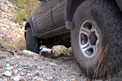

I think that 12 PSI seems to be the sweet spot for these tires. Visually they bulge about the same as the BFG MT's at about 15-16 PSI, and they've held up extremely well even at the lowest pressures.
Wear
Despite being a relatively "soft" feeling tire (compared to say the Toyo M/T's, where the lugs feel much harder) they've worn incredibly well. I've taken them wheeling quite a bit, and put on 8k miles since I bought 'em. There is some very very small chunking on the outer lugs (only on the outside of the tire, doesn't seem to be any on the inside or in the middle lugs), and some almost "tearing" marks where I suspect they will chunk eventually.
Despite being almost a year old and over 8k miles, the tire tread depth is identicle to the brand new spare that they put on compared to the 3 tires with 8k miles on them. My wife's Toyo M/T's (my old ones) have worn visibly in the same period of time, and she puts less miles on her truck than I do.
I only have limited comparison to other wheels that club members run, but another members experience with the Toyo M/T's seem to match up with mine. Another club member runs the Coopers (I believe), and even after only a few runs there's some significant chunking going on (more so in a few months than mine after almost a year).
You can see in the very first pic how well they've held up, despite plenty of abuse.

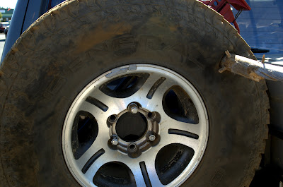

Oh, and I almost forgot. How did I get a tree trunk (albeit a very small one) through my sidewall?
Decent amount of speed (~20 MPH), combined with the tree having fallen to be perfectly positioned at an angle to punture, combined with bouncing off a rock and moving hard sideways into said tree trunk.
Here's a pic of it hung off the back of TOY350's well built 80.
Yeah. The guy who insisted on buying a full sized matching spare.....forgot his spare. (Add: "It's just an easy run" to Famous Last Words.)

Only part you failed to mention was not only forgetting the spare, but forgetting the lug key .... oh wait we were just talking about the tires.
Oh and nice pic
Lug key? What lug key?
Actually it was somewhat disturbing how quickly that came off. Had a 4 way lug wrench, put the right size on it, two taps with a whammer, and it spun right off. If I were stealing tires, I'd laugh at that sort of "locked" lug.

Sidewall damage is never covered. (And technically any "off road" use isn't covered, most tire places around here extend that to mean "off pavement.")
If it had been in the tread.....probably. If it'd been on the shoulder....maybe.
Thanks to the influence California has on us, most tire places won't even touch it if it's not clearly in the tread. I've had tires with a screw on the shoulder of the tire (where the tread is still there, just tapering off), and most places won't touch it.
I didn't honestly expect to get it covered, though I did ask.
