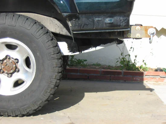

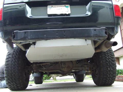

Pics from camping lab. Very quick response.

I believe those are pictures of the Long Ranger brand 44 gal tank and not the Front Runner Tank.

That is correct. He did say that they were pics of a Long Ranger tank, but that the Front Runner tank is very similiar. It was mentioned in a previous thread that installation could be tough. Does anyone have more details on what it takes to install this tank?

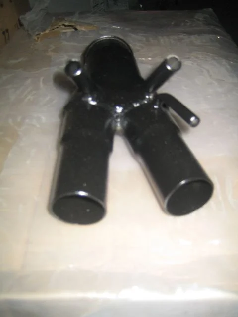

Does anyone know what the Front Runner tank uses for a filler neck? They advertise coming with a new dual filler neck. I'll Email Fernando at Camping Lab and see what he has to say.

Apparently you have you cut the stock filler neck and attach it to the one they give you.

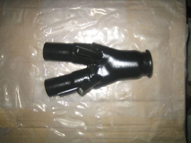

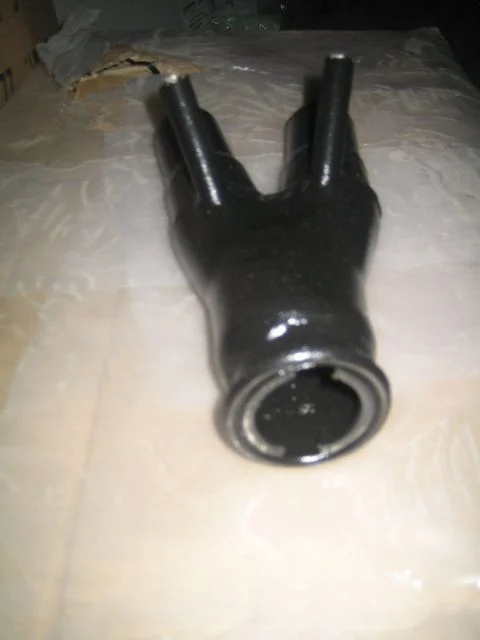

Here are a few pics of the dual filler neck used in the Front Runner kit. It's a proprietary design that allows for fuel transfer between tanks without messing around with the OEM breather lines and also ensures that, if the transfer pump is mistakingly left on causing the factory tank to overflow, this excess gas will flow, through the filler neck, back to aux tank instead of spilling out. This filler neck completely replaces the factory unit.

Quote:
Baja Overland
The pics posted above are from a LONGRANGER tank i'm using them to illustrate how the tanks sits under the truck since both are quite similar in that aspect.

Thanks Fernando. I assume this filler neck has two holes for the gas pump? stick it in one hole to fill the main tank and then the other to fill the auxilary tank? Seems like a pretty straight forward design.
Just ordered one. Now I have something to look forward to when I get back from 3 weeks in sunny Fort Irwin, CA....

it does seem that the front runner or any of the 45 gallon auxiliary tank extend futher back than the one Man-A-Fre 24 gallon sells. This is important if your aftermarket rear bumper has a crossmember/2" tow carrier ie: like lukes 4x4 labs rear bumper.
