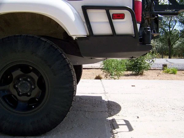

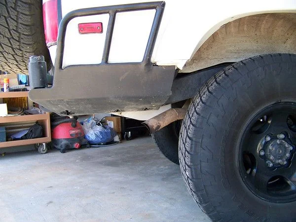

Quote:
Originally Posted by lt1fire View Post
I need to see pics of this installed when you are done. I am on the fence about this one but worried about hitting it on something and also i'm planning on getting the 4x4 labs rear bumper
Ok, lets try some pics.
Jack

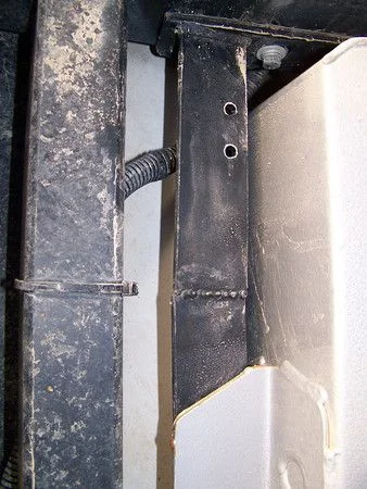

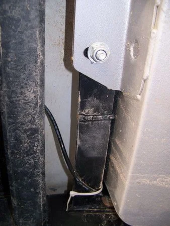

When I ordered the bumper kit from Luke, I specified the rear tank option, which allows the receiver hitch support to be mounted two inches to the rear.
If you do this, forget about trying to use the flush mounted receiver. By moving the support bracket back, it leaves you no room to insert or remove a hitch pin. I cut it back out and bought a regular section of hitch receiver and welded that in it's place. That puts the hitch pin on the out side of the bumper. Granted you loose a little departure angle because the hitch now stick out a few inches, but nothing more than the recovery brackets.
The rear tank support bracket has to have two cuts made because the mounting holes that the tank bolt to are centered. I tried to get a couple of pictures of the cuts. These are needed because the distance between the frame rails becomes narrower due to the wrap around nature of the 4x4labs bumper.
Jack
