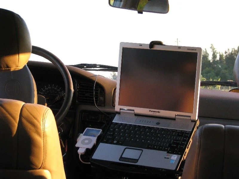

Why would you have to get rid of the passenger seat?
Here's what I have:
It doesn't impede too much on the passengers comfort. The passenger or driver can easily use it by rotating the arm. I'm very impressed with the tough tray however the universal mount is a little bulky looking. If you could use the jeniko mount with a custom bracket to use factory seat holes (seen somewhere here on mud) then use the ram tough tray instead of velcro with jeniko's mount. I don't like using velcro.
I can get a picture of the legs if you want...

Your laptop is smaller than mine... I thought the MacBook Air was small enough for this application, but it really is not.
I'm going to start looking for a small ToughBook.
I would be curious to see how you mounted it... Send me some more pics!!!

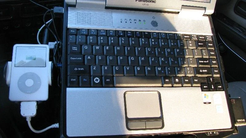

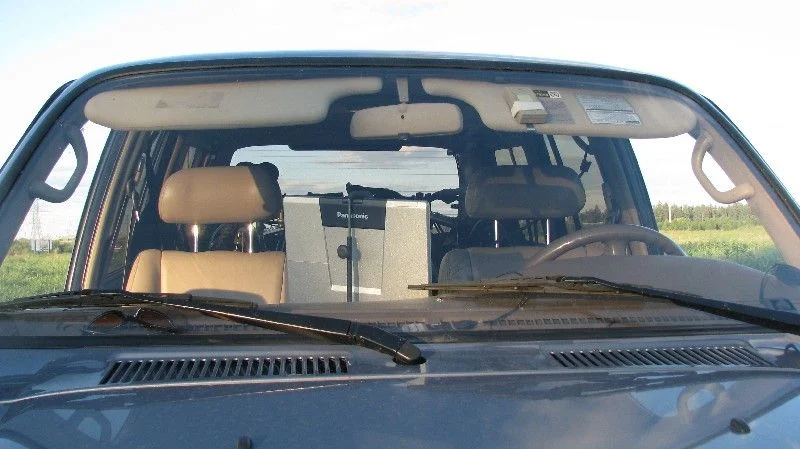

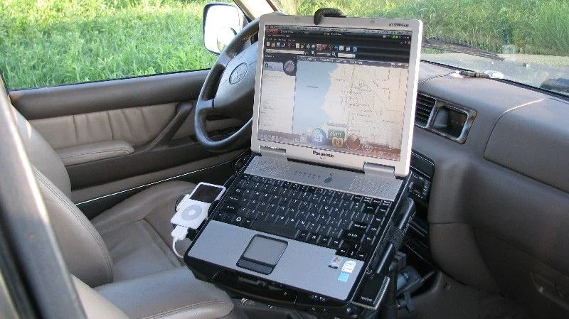

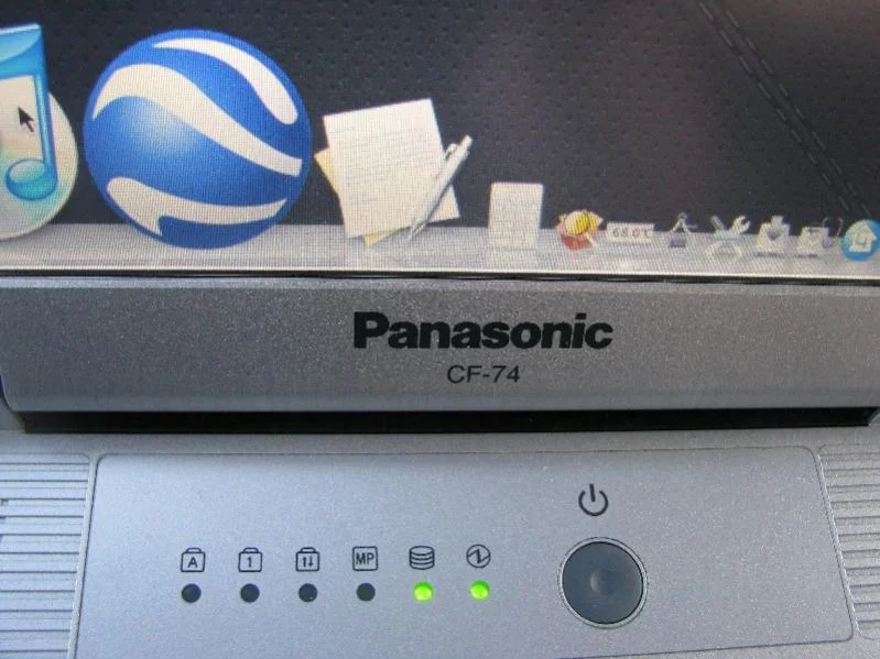

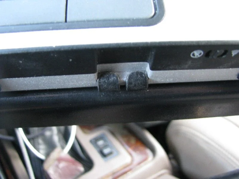

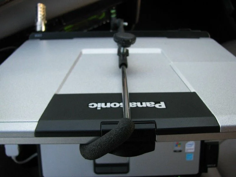

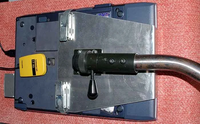

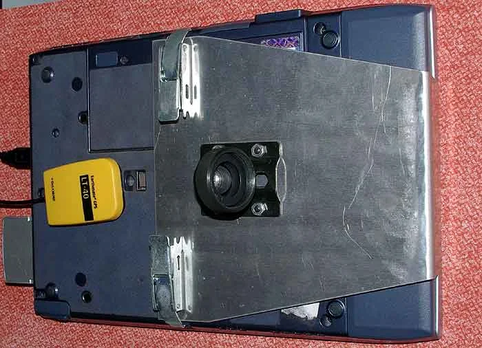

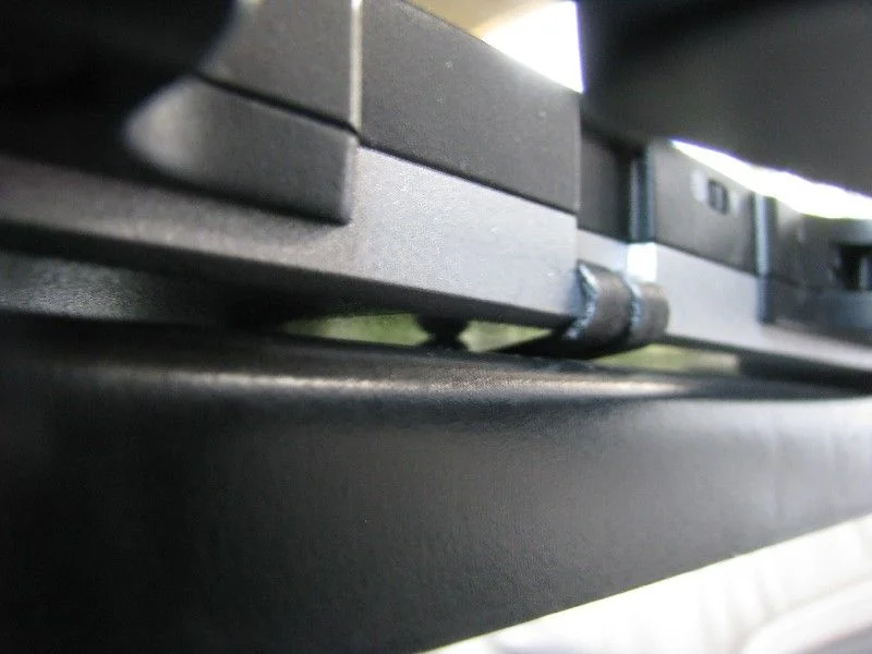

I use Jotto Desk and am very happy with it. For the mount, a solid bar was bent that attaches to the front factory seat mounting bolts. This is a very solid mount. The passenger doesn't feel like his/her space is encroached and the laptop can be placed so that the kids in the second row can watch movies.

Regardless of what unit you go with, triangulation of the mount is key. The more solid the mount, the less wobble you'll experience over long term.

I was on their site and don't see that mount with the curved bar like you have... Can you upload some bigger pics???
It looks like the Jotto takes up much less space...
How difficult is it to remove the computer? That was another problem with the RAM, the computer really needed to be perm. mounted there.

Curved bar was a custom home made job! It had brackets welded to it so it attaches to the front two seat mounting bolts.
Laptop is very easy to remove, about five seconds. Normally I remove the entire top portion of the mount and leave in the garage. This leaves only the vertical riser bar (second pic).
Picasa Web Albums - A.

You should make a few of those bars and sell them as kits!!!
Looks great.

The mount for the slate is a bent piece of aluminum with Velcro and cabinet clips that catch in the docking port holes, slots in the slate.

A few images from today:
It's a universal Jotto mount. I did go into the tranny hump as suggested, but used far larger hardware then the teenie screws it came with.
I also wired up an iPod. Charges off the lighter for now, and runs into the stereo. I also have it wired to a transmitter mounted under the mount.

More...
The laptop blocks also zero view .. and make sure you get the screen holder accessory! Worth it's weight in gold on trails.

Last...
Fastened a steel hook of sorts onto the deck of the mount which nicely traps the iToughbook.

My god man, that's badass!!!
I LOVE the hackentosh Toughbook!
The mount looks great.
Seems like my quest is not over, I have some work to do this weekend.
