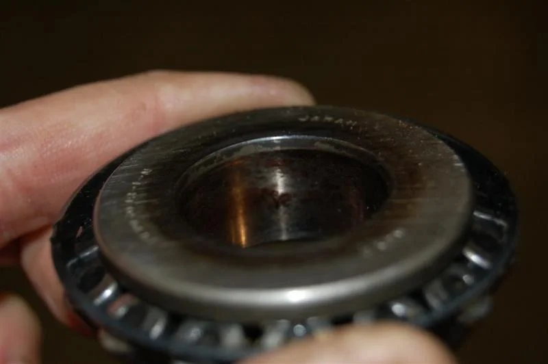

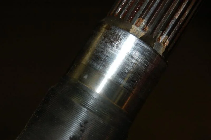

I have had 2 rear diffs now with loose pinion bearings.
Did you have a lot of gear lube slung up on the passenger side upper control arm? That was apparent on both trucks with this problem.
I only broke down one diff and it looked to me that only the bearing needed to be replaced. There was some marring on the pinion shaft but I was able to determine that the bearing race had a slight taper to it.
Here is what I found when I opened one of them up.

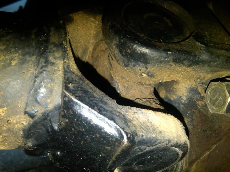

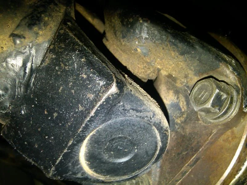

Thanks for your replies... I am getting the loud whirrr and grrrs when UNDER POWER. From all I know and all I've read here those symptoms usually point to needing new U-Joints. I plan on replacing them all and having the DSs balanced at the same time. I don't have the play in the DSs that I expected but the U-joints do look pretty 'buggered up'.
My plan before going to Toyota was to replace U-joints, change all dif fluids, and then begin diagnosising any issues that come up. I think I can still stick to that I may have a few more days on jack stands than I had hoped. I got under the truck and yanked and pulled at the DS and there just isn't any noticable play in there on either side. The flange looks clean and sturdy and I don't have the oil splash on the passenger side. I've driven the truck for 1K miles and I'm sure even if the previous owner had cleaned it up I would have something by now.
The guy drove the truck for maybe 10 minutes and came back with the "PINION SHAFT IS LOOSE!" comment. Is there something that I'm missing when I drive the truck that would point me in that direction? I attached photos of the DS / Flange as well as a closeup of the U-Joint.
I'm still thinking I want to see whats going on in there and take it apart. The FSM notes some special tools that appear to be gear pullers. Are there any tools recommend for the rebuild?
I'll bet he's just unfamiliar with the amount of "normal" AWD drivetrain slop in a 91-92.
For example: How would he even determine from a test drive that it was the rear rather than the front?? (If it turns out you are in fact having diff. trouble, it's much more likely to be from the front.)

Didn't think of the clunk... The tech probably felt the typical 91-92 "clunk" and assumed that it was the rear pinion shaft. Did he physically try to move it by hand? or was it just his idea?
