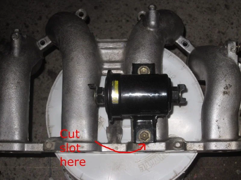

Quote:
Originally Posted by turbocruiser View Post
Does anyone have a pic or can explain how to slot the mounting hole as indicated in sleeoffroad's post #13?
I have this on my to-do list and want to make sure I do this correctly. Thanks.

Here's the underside of the fuel filter.
Left is front, right is rear.
I marked where Slee is suggesting to cut slot. Those are 12 mm bolts to intake.
The banjo's are 17mm I believe.
