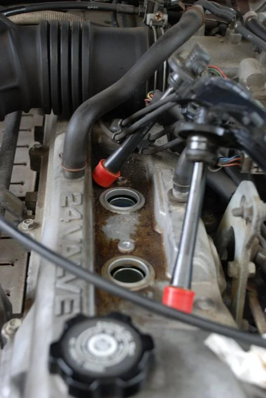

Looking for parts required for valve cover gasket and spark plug tube seal
replacement.
Long story short. I was replacing spark plugs today and noticed two things. Oil seeping from the top of the spark plug boot and a large rock chip on my headlight.
Oil leak appears to be fairly considerable. After forum searching I found the culprit.
I placed an order with Tom at American Toyota (CDan is on vacation) and I plan to replace the valve cover gaskets and spark plug tube gasket repair next weekend. I want to make sure I have all the parts. Normally Dan would guide me but because he is MIA, I'm at a loss.
So far on the list is:
-Valve cover gasket
-Spark plug tube seals
-FIPG
-Throttle body gasket
-headlight
Is there anything else I need? Is there an additional part number for those half moon pieces at the front of the engine?
The LX is completely stock with 200k miles.

Quote:
You only need to mess with the half-moons if you are removing the camshafts. If you are just replacing the valve cover gasket, there is no need to remove them.
If you do ever remove them (to adjust timing or replace the HG etc.), they are reusable, so you wouldn't have to order new ones.
Other than that, I can't think of anything to add to your shopping list.

The Lexus stealer estimated $800 so I decided to do the work. My brother in-law and I tackled this today. We took our time since this is the first time either of us have done this type of invasive engine work. Our experiences are usually with just spark plugs, oil changes, coilover, exhaust installs, etc. It took us about 4hrs total, but with 2 45min breaks. Lucky we didn't break or lose anything in the process.
Parts purchased:
VVC gasket
6 spark plug tube seals
1 VVC screw as backup
TB gasket - (old can be reused if unable to obtain as it is made of metal)
FIPG (did not use)
PCV grommet
PCV valve
Tools used:
Regular 10mm, 12mm socket wrench. Two open ended 12mm and 14mm wrenches for the accel/throttle/cruise cables, screwdriver, hammer, pliers. Flex joint for last VVC nut by the firewall, magnetic pickup tool, pen, paper, ruler, electrical tape, digital camera, FSM and ih8mud links.
We never fully removed the TB, just unhooked the 4 nuts and 3 wired connectors. One of us held the TB while the other worked underneath.
