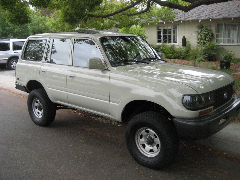

another Beige 80 - Toyota Dune Beige
Specs: 1996 FZJ80. Converted 1HDFT/H151 5-speed. 200K miles. J-springs, BJ74 16" steelies, 285's, Labs rear bumper, Hannaquality sliders (missing in picts). Schlaker helped me remove nearly all the trim, bumpers, weatherstripping, and door panels. I welded up the holes from the fender flares, roof rack, spoiler-thingie, antenna.
Maaco did a... passable job. It's going to be wheeled, so i didn't need show quality. But, I did need to point out to them the flaws (drips, fish-eyes, overspray), three times until I was finally happy with it. But, now I'm battling a alternator gremlin from them killing my battery and jump-starting it.
Anyway, the price was right. Including all 5 door jams, skinning over all my welds, and a new windshield... it was $1100.

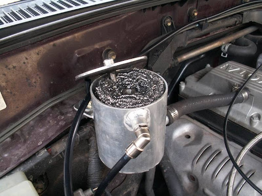

Ok whats the industrial scouring pad for? Oil filer?

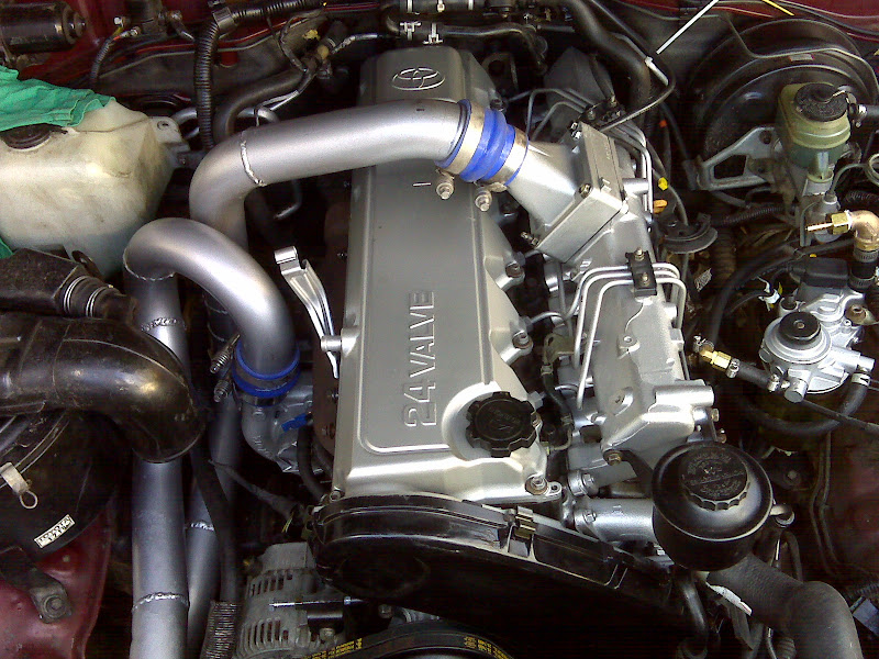

My gosh that diesel looks like brand new

Looks sharp. Beige is good color for the 80 IMO

Quote:
Must have used the scouring pad there instead lol.

Scouring pad? That might b e the pict of the oil fume catch can (pict is in wrong album, that's not my catch can).

Wow, it's amazing what a difference painting the black window frames to match the body color does for the overall look of the vehicle.

I love the Dune Beige. My white paint (upon close inspection) is getting tired. If I repaint, I will seriously consider this color. Perhaps a bit darker.
Your truck looks great!

nice FT .. can you share pics of your intercooler setup . .?
Where did you source ( or is custome ) the flange to the intake manifold . ?

intercooler is a ebay special.
pict here: Picasa Web Albums - Brian
even with the funny bends, it spins up fast, and never get's over 800F (pre turbo; 3" exhaust).
that perfect little adapter on the intake manifold... comes on a stock 1HDFT motor with EGR (it would have been the turbo-output to cross-over pipe connector... but they reused it at the intake).
