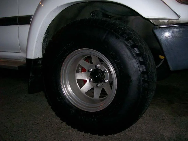

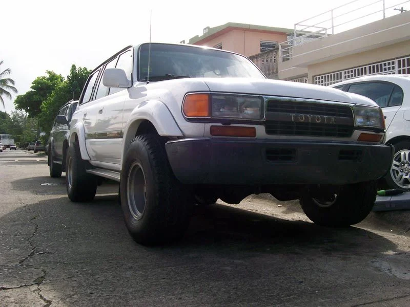

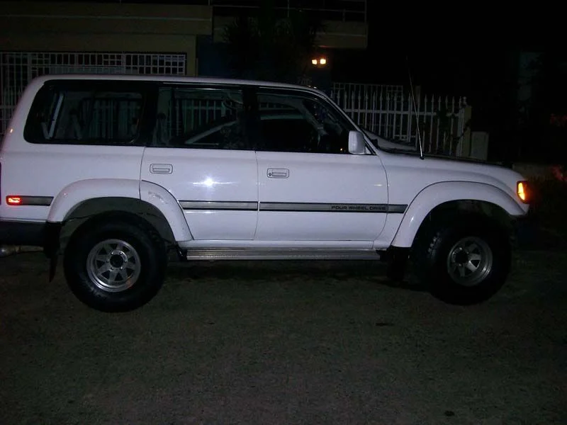

| "El Tractor 2" New Shoes Well, almost new. They were inherited from "El Tractor" ( my old 60). One rim had to be fixed from an accident. The tires are 33's and the wheels are 15x10. due to some small rubbing. Tomorrow I have to trim the front corners on the bumper The pics are one before and two after. |

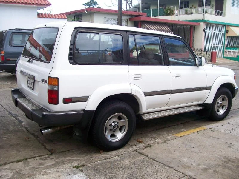

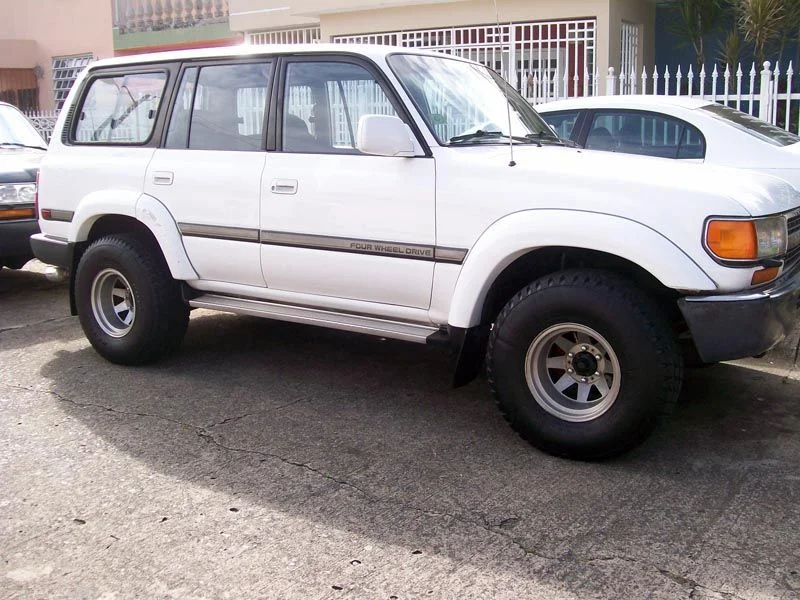

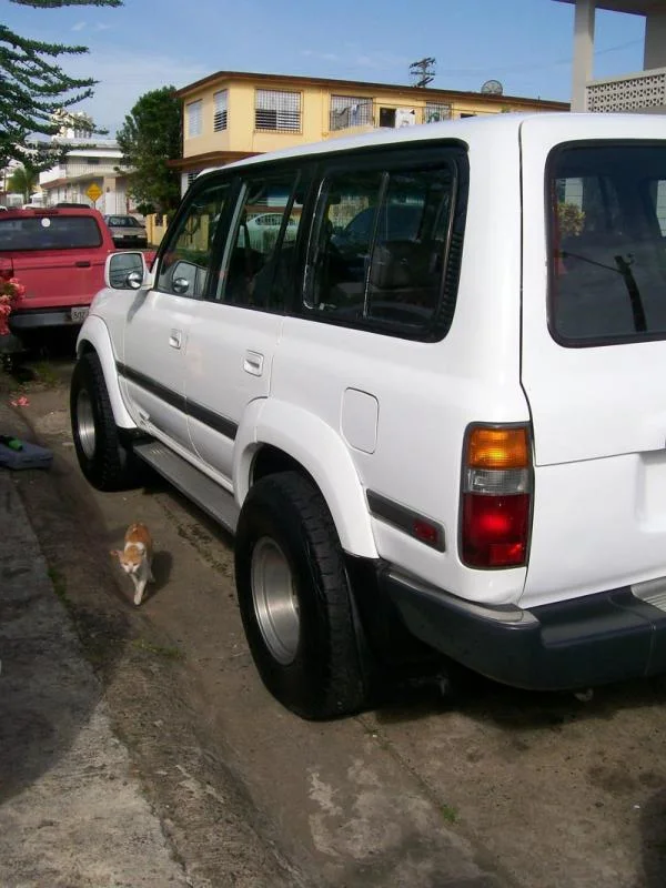

| More Pics Here are some daytime pictures, found a small problem; when I do a full wheel lock turn, the tires rub in the back of the fender. Any suggestions? |

| I had these set on my 60 and had no problems, I think that if I can get the truck lifted at least 1 inch, the problem will be solved. First I 'm going to try re adjusting the wheels stops. |

| They rub in the back not on the bumper, I already sawed some of the plastic. These are as ugly as the white spoke steelies, but they work great off road and they keep corrosion (major problem here) at bay. Spacing will not do anything, I think I'll have to move the lift kit up in the to do list. |
