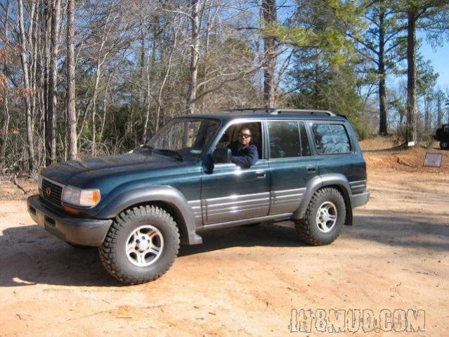

im running 35" w/out a lift! I do have a 2.5 inch heavy OME lift in plans

yup; mediums and 255/85's here, no issues, no CC bushings yet, no problem, no drama.
I can't remember but I think the picture was taken pre-lift too.

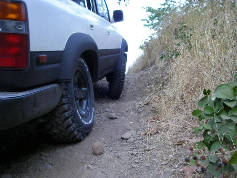

285's and ome mediums are not ideal for the con but are workable. The po of my truck did the con with 285's way back when 80's on the con was almost unheard of. I have wheeled sections of it with the same setup. If i did not have a prior obligation I would be participating in this years rubithon with my truck (with 285's and ome mediums). I would like a slightly bigger lift and 315's but am on a budget and have a hard time justifying the lift, tires, gears and rear bumper to store the spare. btw, with stock gears and 285's my truck tows a 3,000 lb popup, hauls 3 rows worth of kids (with spare underneath) with no problems at all. I have some pictures in my rotw in my sig line.
