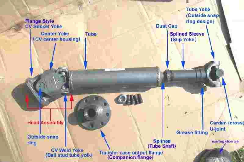

Quote:
Originally Posted by LandCruiserPhil
...Curran are you sure grease is spitting out of every cap?
I thought it was. Is this something that you can over grease? If not, I'll go home and push more grease through.
Here is a picture (blatantly stolen off of a pirate4x4 tech page by BillaVista) of a double cardan to help with the terminology for newbes like me:
Thanks,
Curran

The hole is on the part that is marked Center CV Housing.
