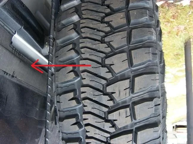

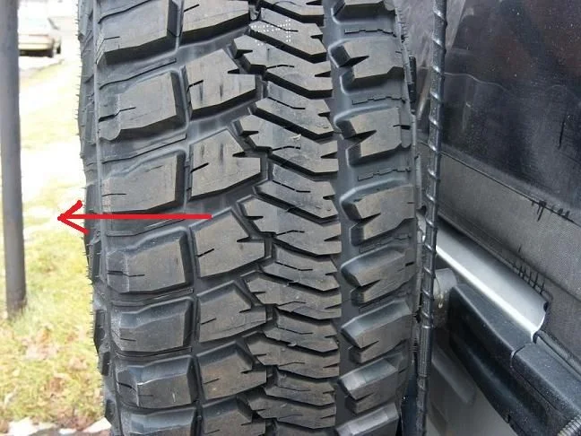

Side by side comparison with RED ARROWs pointing to outside:
With the OWL either out or in, the direction of lugs (inside and outside) stays the same. Even though they are asymetric. I have confidence GY stating that it would not matter which side you run (as long youre consistent with the rim placement), I would run it with the two big lugs out from the 1st picture just to be comfortable.
Edit: If there are no indication on the tire which is in or out you can look at the second picture in how it would look with the arrow pointing inside with the tow big lugs outside. But as you can see if thats the case, the two outside lugs would be different direction from the left side of the truck (compared to the first top picture). Making it seem they are supposed to be directional.

It's not difficult to see what you're talking about. When mounted on a vehicle, the tread blocks will be pointing forward on one side of the truck, and backward on the other. The effect is purely aesthetic. Almost all tires do the same thing. Go take a look at your truck tires. Odds are, the tread on the outside edge of the tires will be oriented either forward or backward on one side, and reversed on the other, unless you have directional tires (and they're mounted correctly). With directional tires, the tread will be oriented the same way on both sides of the truck (or car, since most directionals are sport type tires).
The only difference with these tires is that the tread doesn't follow the same pattern on both halves of the tire, so the tires are supposed to be mounted with a particular side 'out'.

I agree with Spike.
In every photo of these tires, they are mounted with a particular side out.

So if Goodyear states to run the two big lugs out:
285/75/16s force you to run the OWL outside. Therefore run 315s if you want to have the BWL. How convenient!

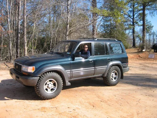

I'm running these on my rig now. 31's.
To put the argument to rest, they are 100% NOT directional.
Finally got around to testing them out on the road/rain/greasy mud.
They are not quiet like the AT's. You can definitely hear them but they are not as loud as a full on mud tire.
I would rate them in between the BFG AT KO's and the BFG MT's for noise.
They track straight on dry pavement and stop/corner much better than the last generation MTR in the rain/wet pavement.
In fact, they stop better in the rain then my BFG AT KO's.
Thin/wet greasy mud was good. They self cleaned very easily.
You can feel the low rumble from start to about 20mph. Of course I'm sitting above the tires so the sound/vibes are more pronounced.
Was running 38 psi on the road but found it to be a little rough so aired down to 28-32 and it rides nice.
Today was a nice rainy day. They performed well. Hard braking and hard cornering, there was no slip n' sliding which I am very impressed with.
Overall, for road manners, I'm impressed with these being an all-terrain tire guy.
