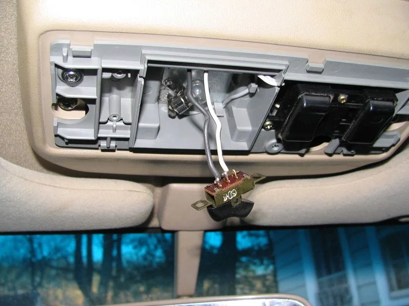

The first picture is of the switch - I had pulled it out to see how I would modify it. Sorry I didn't grab a pic of the spring metal stuck in there - I will try to add it tomorrow when it is light out.

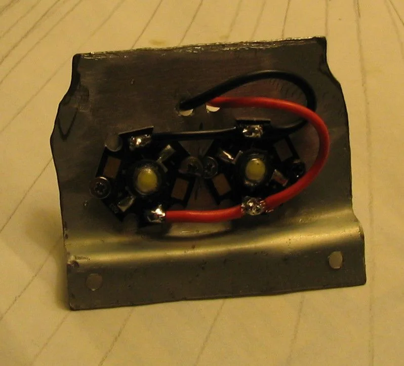

The second picture is of the base plate I used to mount the LEDs to and the nFlex driver over.

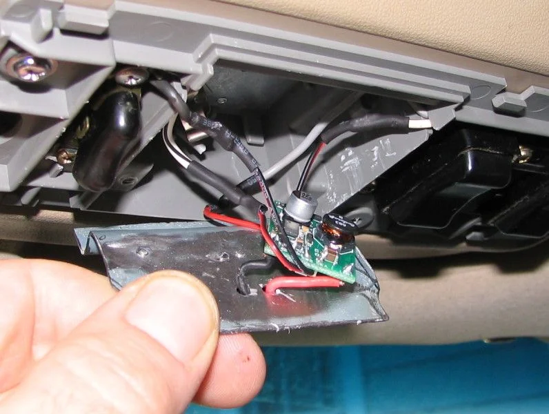

The third pic is of the LEDs mounted and wires soldered and routed to the back. I used heavy gauge wire here to avoid shorting over time as it passes through the metal plate.

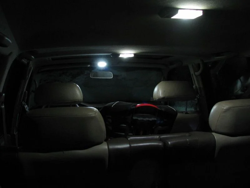

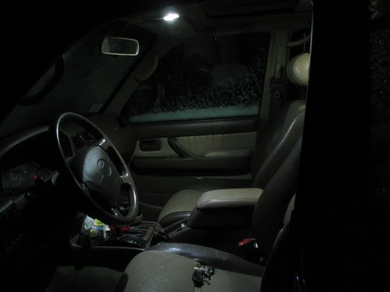

It is always hard to show light levels - so I took the pics showing the two dome lights in addition to the map light. The first pic is with the map light on low and the second with it at its brightest setting.
The third pic exposes what a mess the truck is - also at the brightest setting.

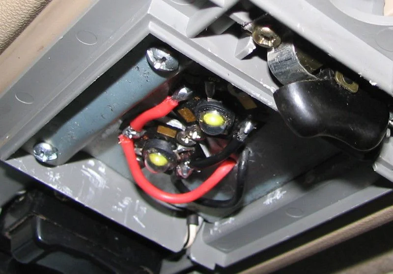

I just wanted to add the pics that were missing. The first pic shows the spring steel that mechanically pushes the switch to the off position, the second is the nFlex driver above the metal mounting plate.
