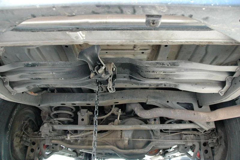

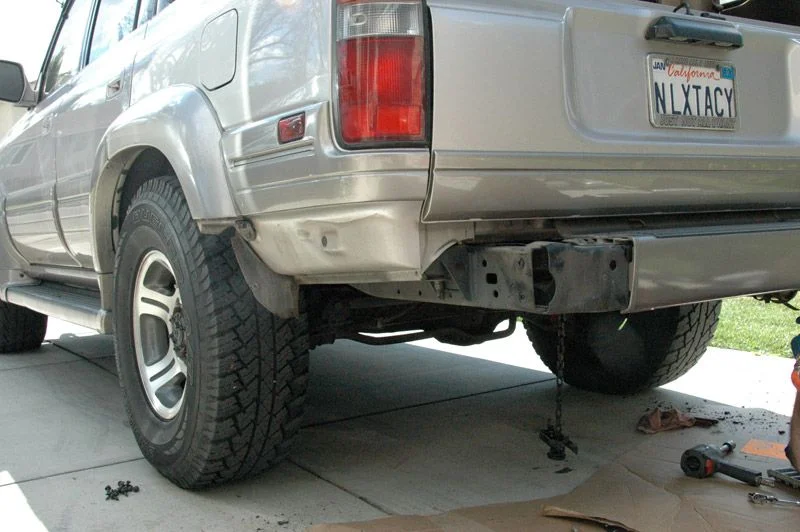

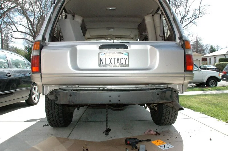

The tear-down was pretty easy especially since we used air tools. Just figuring out which bolts to remove and then just disassembling the rear bumper and then removing the tire carrier cross-member. I was REALLY surprised at how little there really was to the bumper.

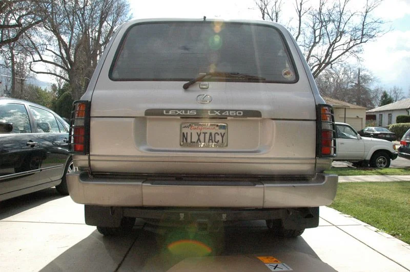

OH! and just so you guys know..... THIS is what a well maintained CALIF truck looks like under the chassis

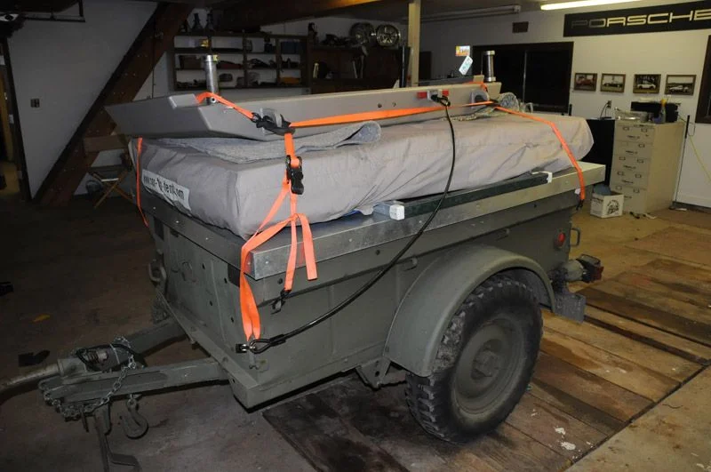

The new bumper pieces

Poor guy was under the truck doing the long bolts thru the sides of the frame and one wrench decided it didn't like the way SPIKE was touching it so it bit him good on the noggin. Good thing I had wound closure strips in my EMT kit.

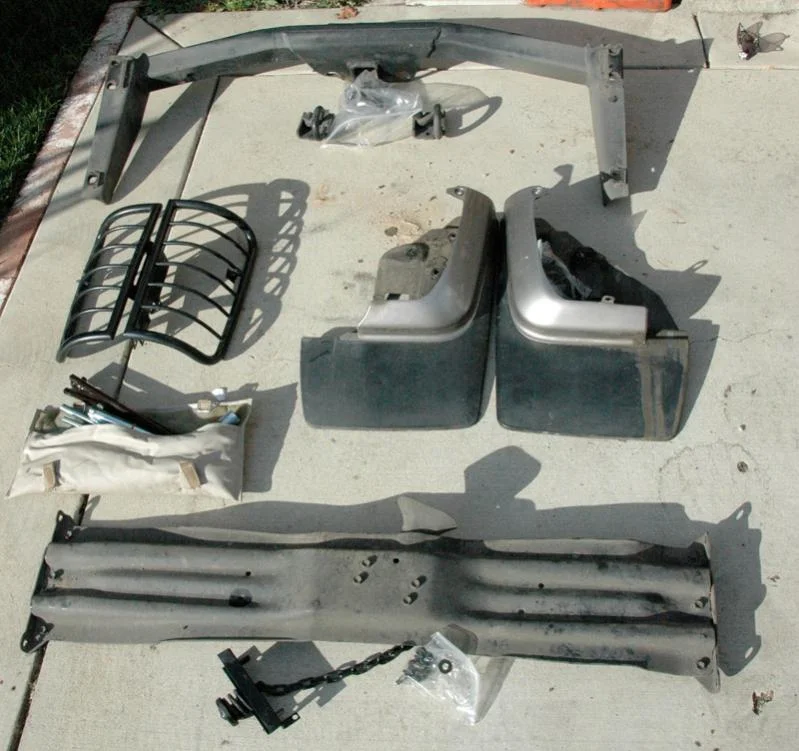

So here are all the parts that were left over and are currently for sale

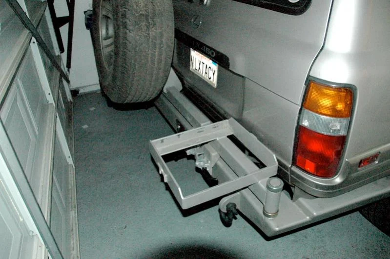

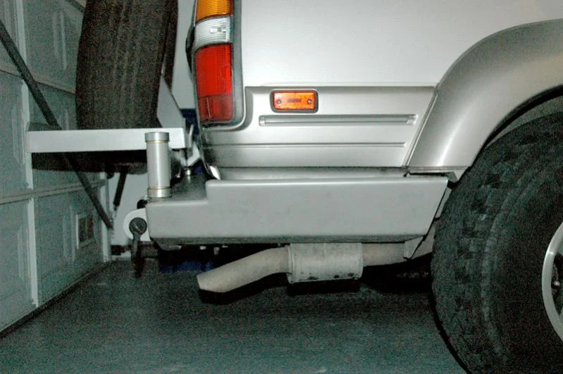

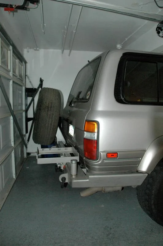

So this is how it sits in my garage. BARELY clearing the garage door. Tire sits a nice distance from the tailgate and the overall fit and finish is really top notch. IPOR kicks ass

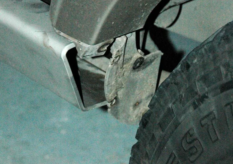

So now come my questions and I would also LOVE to hear about mods folks have done to the IPOR bumpers.
My first question is what have people done about mud flaps? Is there anyway of using the stock LX flaps? There is an opening to the bumper that I know will get mud and rocks shooting into it. Also being in CA I KNOW I will get a fix it ticket for not having mud flaps
Second question is about the resonator and tailpipe. Has anyone modified it or done something to it to get it tucked up higher? It looks like its just waiting to get smacked.
Third question, where the bumper meets the frame there are two threaded bolts into the frame. Well there is a 1/4" space in there that when we were installing it, that space was acting as a void and was making the metal of the bumper start to twist to fill that gap as the bolts were tightened. Is there supposed to be a spacer in there? What did you use?
Fourth question, what did you use to secure the fuel tanks on the bumper? Yeah I could use straps but that only keeps them from falling. What keeps them from walking away? What keeps people from sipping my gas?

Quote:
There is supposed to be a washer between the frame and bumper there to level out the gap.
Lance

Lance seriously...its like 6AM there, what are you doing up already?
I was actually going to use washers but wasn't sure if maybe there was a special plate that is supposed to go in there. Do you know off hand what size washers so I don't have to go down and measure?

Oh man, I get up at 4 am every day (entrepreneurial disease). The question is, what are you doing up at 2 AM?
Our hardware kit is supposed to include several washers that are used to level the wings as well as back the frame mount at this gap. The bumpers are laser cut, CNC bent and assembled in a jig, but very minor variations at the frame mount can be 1/4" gaps at the end of the wing - thus the spacers.

Joey,
Bumper looks great! I was going to modify my oem mud flap to fit but I tend to rip it off every time I go wheeling so I am going to go with a flexible rubber flap to try to reduce this. Just food for thought.

I figured there were supposed to be washers in there somewhere...

I have yet to have an issue with mud collecting in the bumper wings. It does get in there, but the powder coat is a protective layer. I just hose them out every so often.
I just ratched strap the gas/water tank down on the carrier. The best deterrent for people stealing gas out of them is either a lock on them, or a gun.

Are the dual swingouts an option on the IPOR rear bumpers? On their website I just see the single swingout rear bumper. Also, how does the jerry can holder perform? It looks very minimum versus other bumpers.

yes they are. Honestly, almost anything is i'd imagine if you just called them up and asked. They are outstanding fabricators and great business men.

Each carrier is a little different - they're all designed to customer request. Some are fancy, others are not. I had wanted to do a pre-fab carrier, but as with many other things it's hard to find a "one size fits all" solution.
HTH,
Lance
Welp I need to order those from you. I will call in the morning.
This would work on a non-LX. I will take a pic of the flaps so you can see what I am working with and why it wont work with the LX flaps.
