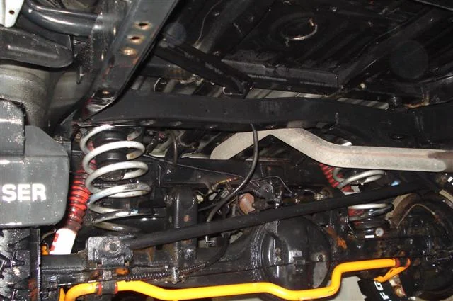

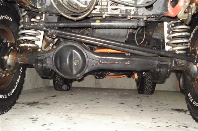

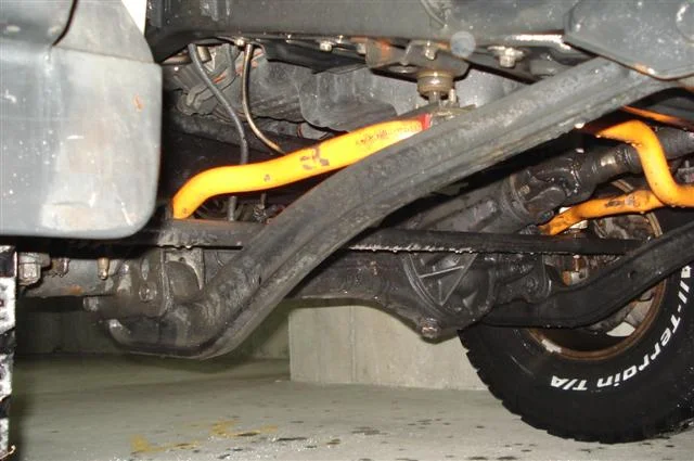

photos
here are some pics

Bump for any further thoughts. Was hoping some of the more experienced types would recognize any of these components or offer some advice to make my truck safer or more reliable. I am not adverse to some Slee arms etc. if required, but was hoping to do it right the first time...

Being all JDM import I don't know where the stuff came from.

few thoughts:
1. you are measuring right it sounds like. 5 - 5.5 inches of lift.
2. Do you have a DC front drive shaft?
3. It is possible you have a replacement front anti sway bar that does need the drops. (did you paint them yellow?)
4. With 5.5" of lift, and no caster correction, you will be very darty. I have 5 with slee's plates, and it is almost manageable.

1) I see darn near 25 inches on the tape at the center of the bottom of the stock flare to center of wheel
2) Think D/S is stock but I likely couldn't ID a DC shaft anyway
3) These bars are aftermarket from Japan. I got them this way.
4) I agree. Am trying to correct this. Awaiting a reply from Slee.
