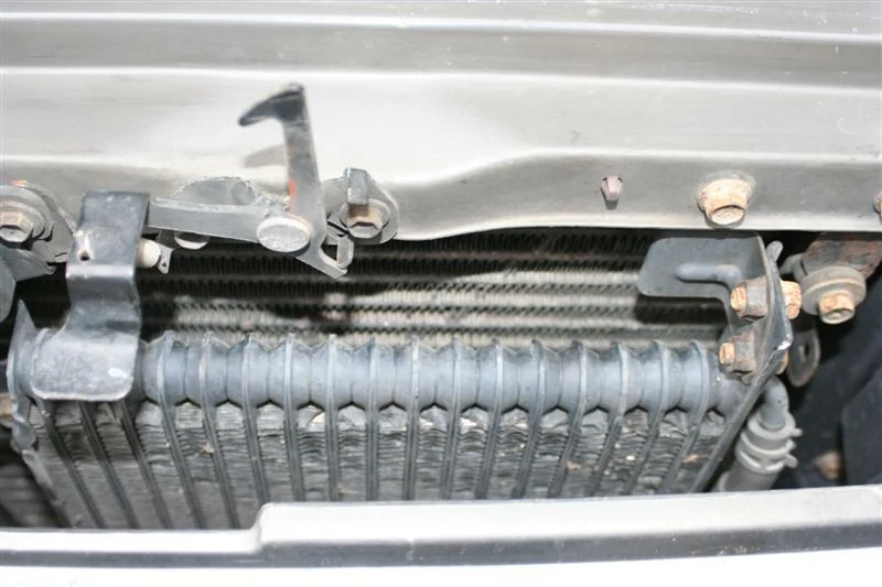

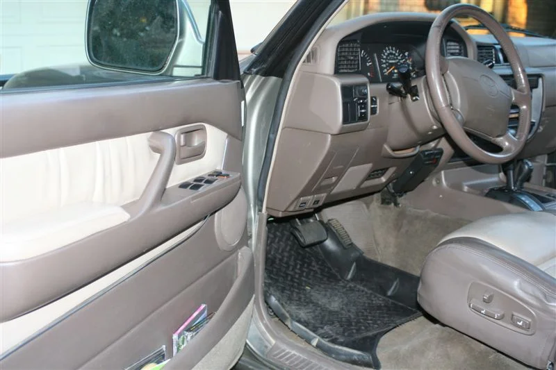

Looking at a locked 40th. Need opinions.
I know that some of you hate these threads and for that I apologize. However, this is the place to go to seek the advice of the gurus.
Here is the deal. It is halfway across the country. I have found a locked 40th with a 2.5 OME, Sliders, and ARB winch bull bar, fancy stainless exhaust, center lock mod. 295 BFG ATs at 50%
160,000 on the rig. Current owner has had it for 2 years, since 130,000.
It originally was a Northeast vehicle, it is now a South truck.

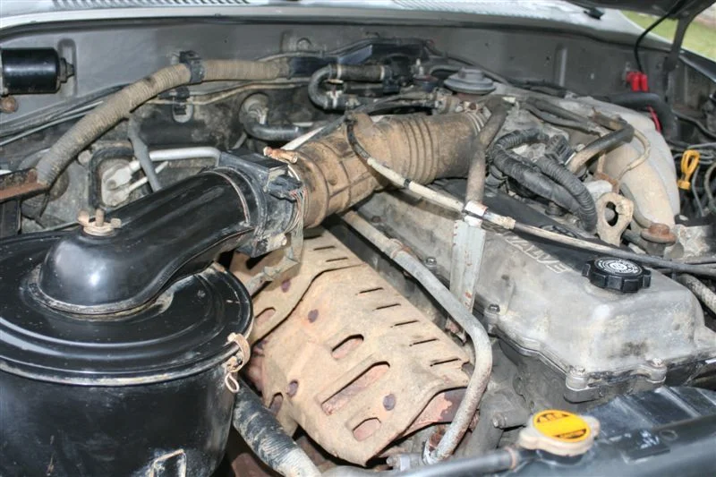

Engine was replaced at the dealership at 100,000. We do not know why. Have not confirmed this at dealership where it was done.
Previous owner had a snorkel, but took it, leaving a hole in the fender. Has new fender. Current owner had all of the dings, scratches, surface rust fixed (near sunroof) and touched up, then re-clearcoated the entire truck. He had the wheels brushed/polished and clearcoated too. The exterior is in fantastic condition. I have the contact info for the body shop and will be checking up on it.
The current owner has spent a lot of coin getting it up to speed. I think it is solid. I have talked to his mechanic, and he has taken very anal care of it.
Everything works, including lockers.
Interior is in good, not great, shape. Driver's seat is holding up well. Rest of the seats are good. A few scratches on the console/glovebox door. PO had added trailer brake controller and screwed it to the dash under the steering wheel (what did he tow?), a 12V plug in the center console above the rear heater controls, and 110 somewhere in the back (waiting on cargo area pics yet).
The bad:
3rd row seats gone (not a big deal to me)
Rear headrests are lost (took out for kid seats, may still have them...is looking)
Fake wood has been removed as it looked bad and was coming loose.
No original floor mats.
General scuffs in the interior. Dash, headliner, and seats are good.
He wants $8000 and is firm. I think he will get it. I know I want it. I have dibs, for now. I spent an hour on the phone with him today and we have been emailing back and forth all night. He is a Cruiserhead for sure that wants to upgrade to a certain bad ass 100.
I am just a bit concerned about its Northeast heritage. I have attached a pic below of the underside. Nothing too daunting. It will remain a southern truck.

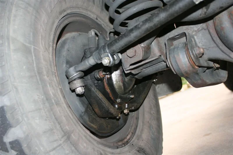

More porn

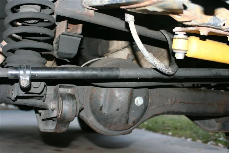

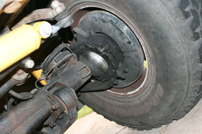

Last porn

Doesn't look bad at all! The interior is fine minus the rear seats missing but I've seen them on Craig's list for $300. Headrest you can get from a juncker. Nice mods. Need to clean up the rust on the rear crossmember though.

Oh, one MAJOR thing I forgot. Will likely need at least one birfield. It is clicking when the wheel is turned, just started, not too bad yet. I am mechanically inclined and not afraid to tackle it myself. What would parts run for a front axle rebuild?

OEM parts for a birfield replacement will run $1000+ for both side. OEM Birfs are very expensive. 3rd party birfs can be had for ~250 per side.
you can swap sides and get several thousand more miles out of a clicking birf.
There is a lot of labor involved, but with Mud backing you up, you will be ok.

The engine has 60k miles, that is not bad.

Just cause its clicking does not mean it needs replacing, just a repack and service, maybe a 250$ job if you do it yourself. A dealer will rip you off and in all likleyhood not do it right.

You only show one shot of the undercarriage but there's enough visible rust there to turn me off. Rust was my number 1 criteria when I bought mine (or lack thereof). I would personally look for one that has never been in the rust belt.
