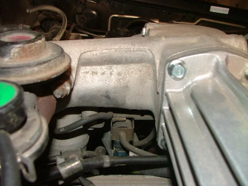

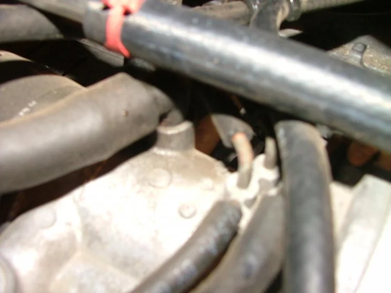

Keep in mind I am confused at which "space ship" is the EGR Modulator and which one is the valve.
Quote:
Originally Posted by Grench View Post
I'm assuming that was a typo.
Thanks for the offer. If you could tell me letter code to letter code for the two lines you have from the throttle body to the EGR modulator, that would help quell a curiosity of mine. Also, did you hose clamp the line on the bottom of the EGR modulator or just stub it in?
See below, I did not hose clamp any lines that went to the EGR Mod
We double checked. I guess we should have checked a few more times 'cause somethin' ain't right.
I guess this is one area my OCD might have saved my bacon.
I've thought about this. I've also considered the possibility that our brand new EGR modulator valve was dead in the box.
I assume it was OEM wasn't it?
I had had this code a few times. Part of the reason why I'd purchased a new EGR and modulator over a year ago and swapped them out when putting in the SC.
Still knockin' on wood. You can see mine have surface rust, but still kickin' it.
I'm going to try to get a picture of it posted up tomorrow. You guys are going to love this one.
I'm very interested to see the pics
Letter code to letter code for the two lines you have from the throttle body to the EGR modulator (Smaller green space ship?):
EGR Mod "R" line --> TB "R"
EGR Mod "P" line --> TB "E"
Also
EGR Mod "Q" line --> to T-fitting on top of the Larger space ship (EGR valve? sorry for the technical jargon) the line on the other side of the T goes to a nipple on the brass square bracket under the intake manifold. From here a line goes to the "yellow filter according to the TRD manual" or in reality the orange T fitting.
Connected to the orange T is a line supplied by TRD that goes to the third nipple on the TB (next to the "R" and "E" nipples on the throttle body)
The OEM line that was connected to the "Orange T" is the line that is connected to the intake manifold opening where the intake runner is bolted. As you can see in the picture, I just left mine there ghetto style because I read that the intake runner gasket covers the hole. I will cap it off soon.
I hope this helps

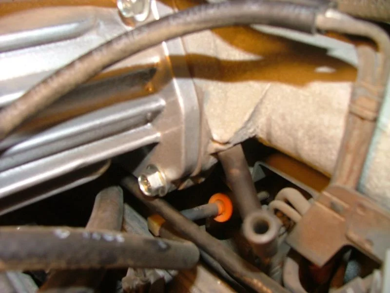

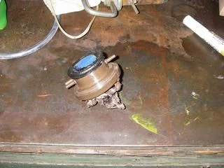

It looks like the modulator end of the little hose popped off, sat beside it, ran exhaust through it like a cutting torch. Nifty.
The old one is going back on with hose clamps.

Damn, that is crazy.
IS that an OEM Toyota part? I thought my factory one is all metal.

It is an OEM part. That is the way the new ones look. The top and bottom shell are held together with glue/press/snap.
The old factory ones are plastic top & bottom with a metal ring around the center holding them together.

On my third EGR modulator valve
After adding this one to another EGR thread, I realized that I never did post back what the results were on my EGR meltdown.
From above, you could find that I replaced the melted down EGR valve (pictured) with the old one (metal ring) and hose clamped it on.
2 weeks later it blew out the new hose (OEM) and roasted the exhaust side port right off of the 'old' valve.
Why?
Clogged catalytic converter. It was resulting in so much exhaust back pressure that something had to give. I replaced the exhaust and put a third new EGR modulator valve on it with another new OEM hose. So far so good. Third time's a charm.
