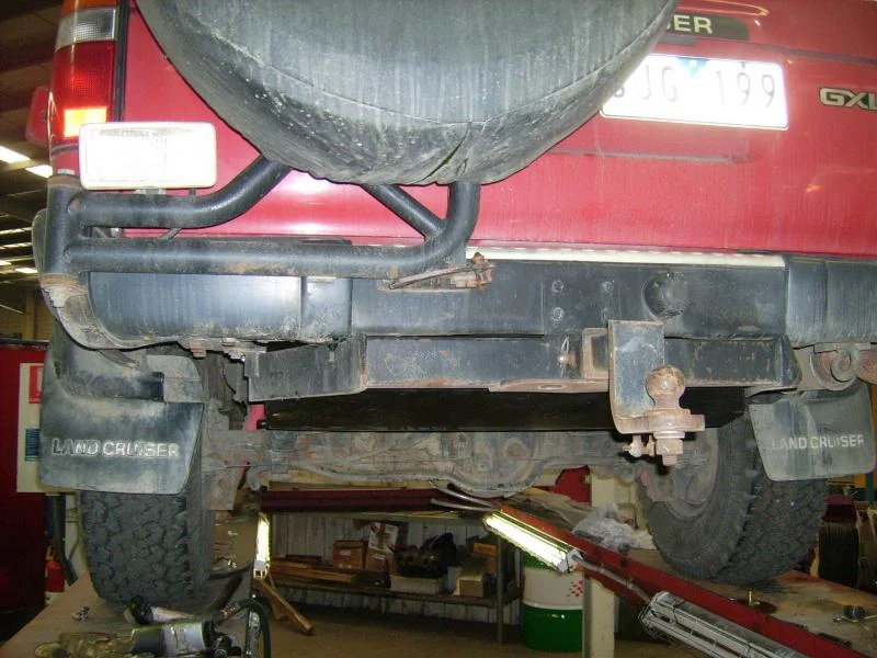

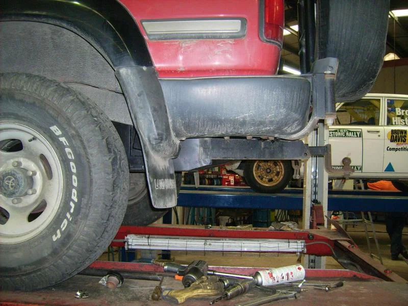

What they are asking for are pictures of the underside of the vehicle as described below. My Lexus 1997 LX-450 is with Landtank right now so I cannot take pics.
We really need some detailed photos of the underside of the rear on your vehicle to confirm this at this point. We would like to clarify before we make any definite decisions.
If you can, take a few snaps of the rear underneath of your vehicle where the spare wheel is, and also under each side of the car giving us good detail of alongside of the chassis rail areas on both sides of the car. We may even be able to indicate whether you can run one of the secondary replacement tanks where the Australian domestic models have a auxiliary tank from factory. This opens up the potential to possibly run another 155ltr tank alongside this also. But without photo’s we cannot tell.

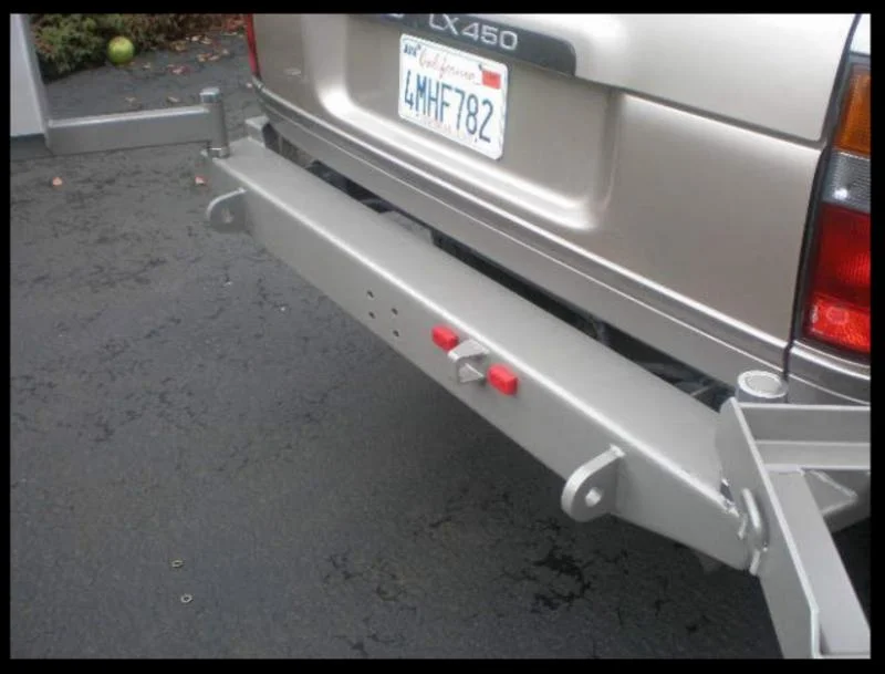

Send pics and I will show them and ask...
These are the initial pics they sent me. I am getting better ones.

Thats not bad.
Im interested. - How did you get to 87 gallons?

I wouldn't mind some more pictures of their bumper spare tire mount, that looks like an interesting design the way it goes underneath the bumper via a metal "strap".

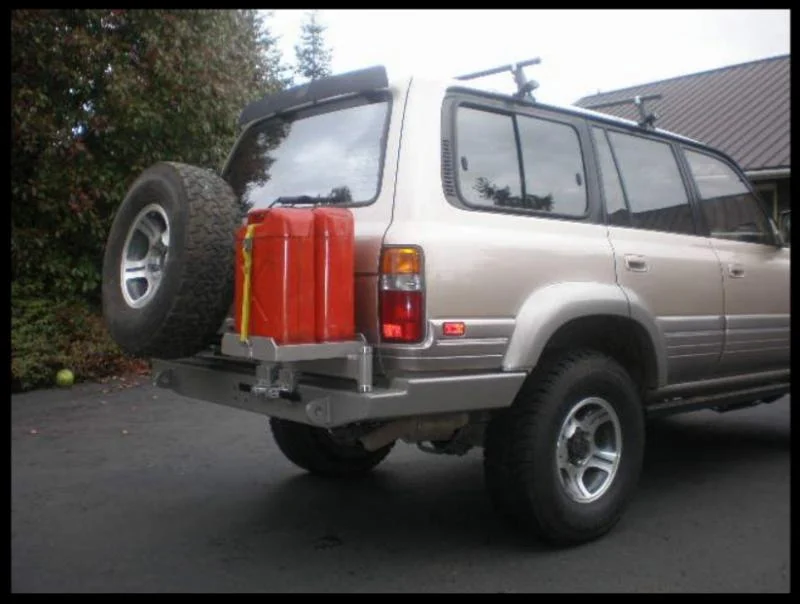

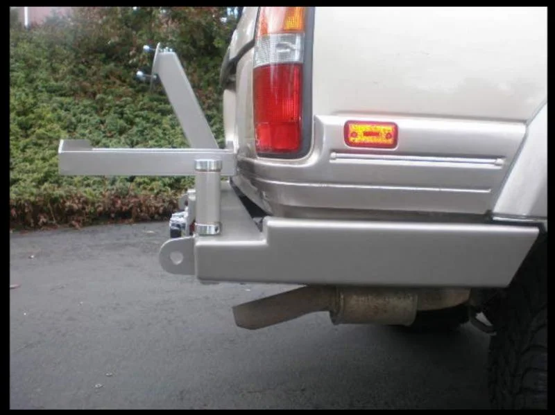

Thumbs up
Here ya go (I need to get some shots of underneath). Not my truck but it will be my bumper

I can snap some pics of my 94 sans spare in the morning when I get off work if no one has...Interested but got some many other things to do first..
