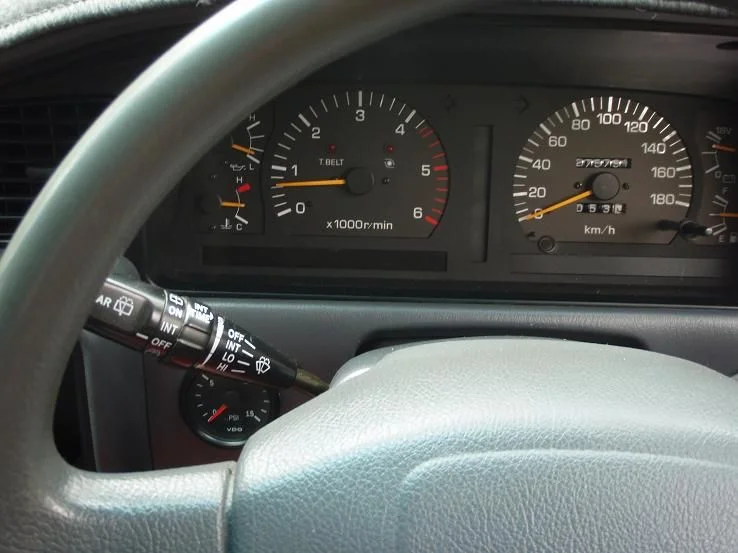

Quote:
Originally Posted by FourBy4Toy View Post
Judging by the picture of the tach, looks like around 4200RPM
I didn't even see that.. was too busy ogling the shifter (and the sub tank switch).
To the OP: Good call on opening up that exhaust. It will likely pay for itself with increased mileage. Please post back with your findings.

1600 RPM seems pretty high for the boost threshold. What's the redline for the 1HD-FT?
Redline for the 1HD-FT is 4300rpm according to the tach. The turbo comes on bosst at 1600rpm and the fun is over by about 3000rpm. I'm bolting on the new exhaust as we speak so i'm keen as mustard to see the differance!

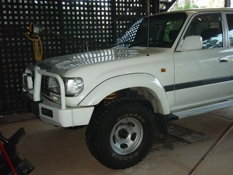

I finally got around to swapping my tyres over.
The 305 maxxis bighorns look way better on the HDJ80 than the stocko tyres that came off!

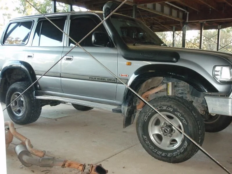

Meanwhile my FZJ80 looks kinda stoopid with the small tyres now. I think she feels neglected and realizes that she's not the favourite anymore, as the battery main battery in it has slowly died on me. It's like she knows she's gotta go...

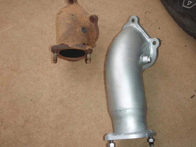

The 3" mandrel-bent exhaust has been bolted up already along with the turbo-timer. The winch bar is going on as we speak and i'm almost done installing the boost and egt gauges.
The exhaust made a big differance, and the turbo spooling up sounds awesome.

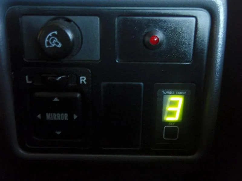

I got the turbo-timer off ebay and i liked it because it fits into a factory blank position, giving it a factory-fitted look.

can you share the turbo timer details .. ?
Nice cruiser dude ..

Hi Tapage,
The turbo-timer is a "Miccon" unit. I bought it off Aus ebay, but it says they only deliver to Australia.
It's a simple unit, with 0-9 minute settings, that is easy to wire up. It fits perfectly in a spare blank spare switch hole, so it looks factory fitted. Thats about all the info i have mate!
Turbo timer Toyota Hilux ,LandCruiser, Prado early - eBay Turbo Parts, Performance Parts, Car Parts, Accessories, Cars, Bikes, Boats. (end time 12-Dec-08 11:19:05 AEDST)
thanks dude .. apreciated.

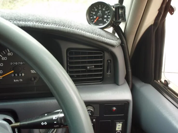

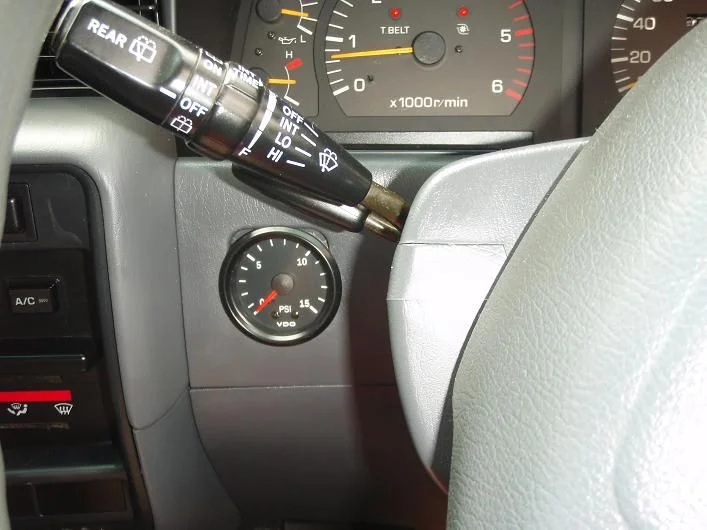

Here's some shots of my new gauges. I originally was going to put the boost gauge in a pod on the pillar, with the egt gauge, but because it is mechanical the fitting and pressure line sticks way out the back of the gauge. The gauge cup would need modification and i was beginning to think it would look a bit congested with them both on the pillar. I decided to fit it in the blank position were the factory diff-lock switch goes...i think. There is heaps of room behind there and it just need some minor surgery with the dremel to fit snuggly. I like it down there as it's out of the way, yet i can still view it throught the steering wheel. 10.5psi boost stock standard!

Very nice rig. what is the T belt light for on the RPM gage?

Quote:
Tells you when to change the timing belt and comes one every 90kms or sumthin like that....
Timing belt light, Comes on every 100,000km's to remind you the timing belt needs changing

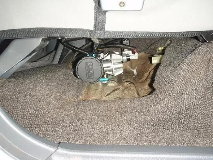

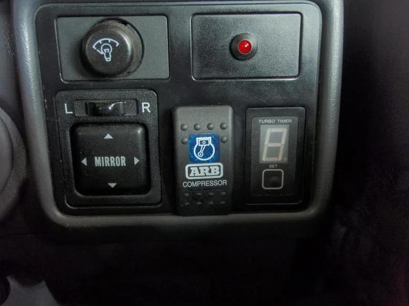

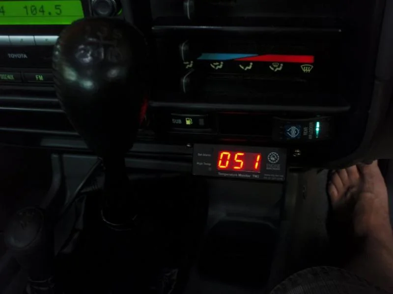

Done a couple more small things over christmas. Swapped over my air-locker compressor and switches from my petrol 80. Still need to swap diff centres over though...
I mounted the activation compressor under my seat and it fitted nicely. There was already carpet removed from that area due to something the PO had mounted under there. Whatever they had under the seat, they did a **** job at cutting out the carpet!
Once i pulled the loom out, and checked the arb wiring diagram, it was dead-easy to wire into the new cruiser. I placed the switches in different positions to where they were in my FZJ80. I put the isolation/compressor switch over on my door side to stop any accidental knocking of both switches together as they were mounted next to each other, on the centre console, in the other 80. There is a spare switch blank next to the rear locker just in case i decide to put a front air locker in too later on.
I also switched over my digital engine temp monitor as well and mounted it low, but still easy to see.
