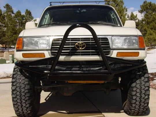

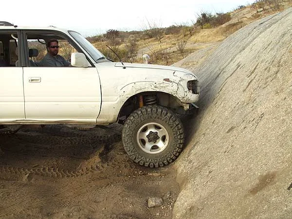

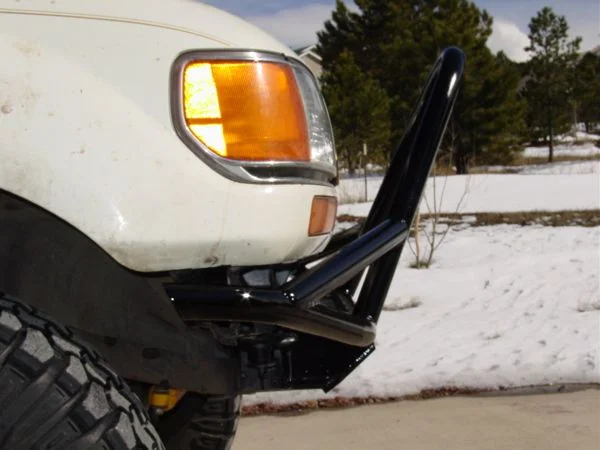

Sure, go custom. Under $500 from SROR. Lighter than ARB. Stronger than ARB for rock crawling purposes, far better clearance.
I'll take it for deer, too. Stinger will push 'em down and under

Quote:
Originally Posted by 80t0ylc View Post
I don't know if I'd say "huge", it's not any more huge than the 80 is huge. You know, when you come off the Desert and into the Woods or Jungle you might just appreciate the "
street battering ram" ability as you call it. ...
I have never wheeled in the jungle, but have plenty of woods time, that’s where we wheel in the summer. Agree that the ARB is well designed for mowing down livestock, even has the air dam to deflect guts, entrails, etc down so there isn’t as much to hose out from under the rig.
From a wheeling point of view it’s huge, sticks out way too far. Here is a poser shot to show the point, Spike can climb that without issue. On mine even with the larger tires, the front tires are 6-8” away from the rock, can throttle all I want, it just digs 4 holes in the ground. I can get up it, have to approach at ~45 degrees, get one tire on it, turn uphill, lock and climb, not the best method and on the trail there often isn’t room for those shenanigans.
__________________
Kevin Patterson '96 LX450 '84 4x4 Mini '73 FJ40
Copper State Cruisers #007
"We have come to the conclusion that we can run our car over any road that a man can take a team of horses and a wagon, providing we can get traction." Dr. Horatio Nelson Jackson, 1903
Tools R Us is online now   Reply With Quote

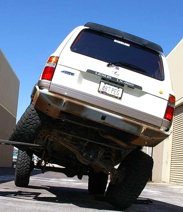

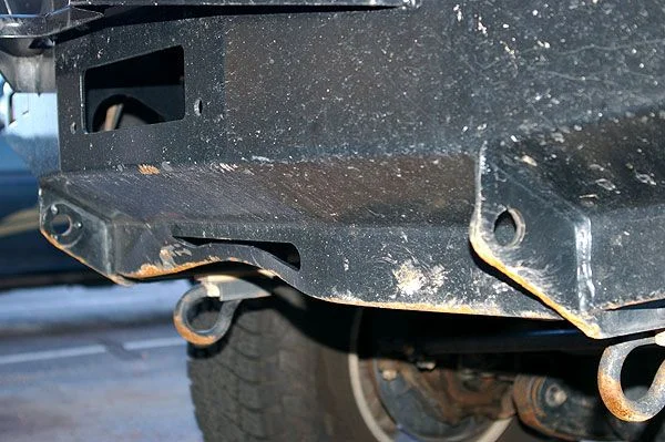

… The air dam IMHO, does not intrude that much into the approach angle considering the kind of vehicle the 80 is. When you modify your rig to the extreme for a particular type of terrain or type of off roading (Rock Crawling or Pre-Runner for example), you are probably going to sacrifice the versatility of the truck. To me, that's the beauty of the 80, it's versatility bone stock! Also enhanced by it's quality and ruggedness. I will modify my 80 only to the point where it improves it's overall performance. I want to be equally at home in a Mid-west blizzard and Death Valley heat spell, or at least as much as possible. And I think that's the way Toyota designed it to perform. It doesn't mean that I can't make imprvements. That's one of the things I like about IH8MUD. You can pick and choose from other peoples victories and mistakes and share your good or bad fortunes with others willing to listen and contribute. Anyway, I think the ARB is one of positve all around improvements that can be made to the 80. Thank you ARB!!! -Tom
Mine rig isn't stock, OME lift, bigger tires, bumpers, so have probably lost it’s “versatility” but have wheeled it in the desert, rock, sand, woods, snow and mud all in one day, it works for me.
I agree that Mud is great for learning from others. I my case the ARB was my first purchase for the rig and for my uses the worst $$ spent, it’s my #1 cause of being denied on obstacles. If the plans for the rig is forest roads, any bumper will work, if deer, etc are a problem the ARB is probably the best for running down critters. If the plan is to wheel, challenge the rig, in my experience the ARB is the worst of all that I have observed on the trail.
The first picture is a properly designed bumper, it has correct angles and smooth surfaces that will slide onto, off of obstacles. The second is a very poorly designed bumper, the angles are all wrong and has too much stuff sticking out to get stuck on. When it comes in contact with an obstacle (rock, wood, dirt, it doesn’t matter) the chances of it sticking/hanging are very high. When it sticks, the relatively vertical angles make it weak, causing it to bend where a smoother, better designed bumper would just slide, transferring much less force to the bumper, truck.
__________________

Quote:
Kevin, is that a custom rear bumper? It has the same design I'd like to have someday.
Also, it sounds like you need to let me take that junky ARB off your hands so you can get something with a better approach angle
